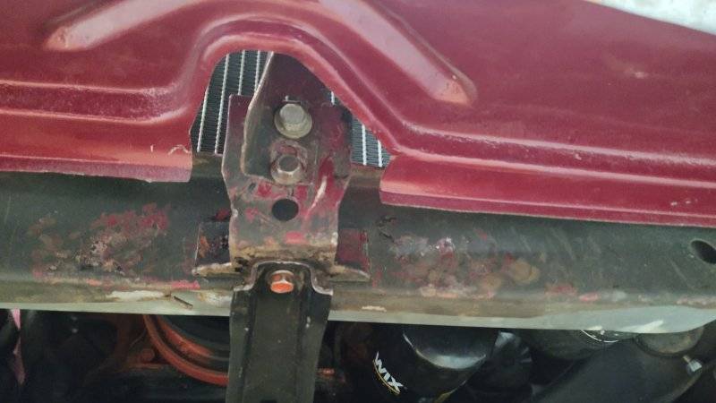

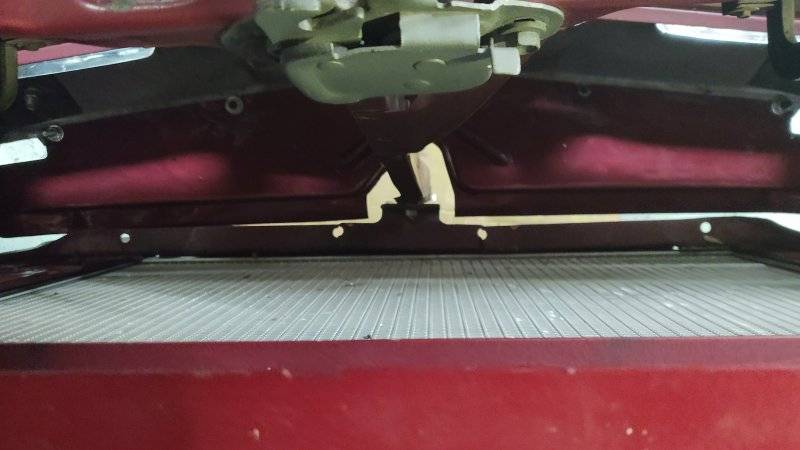

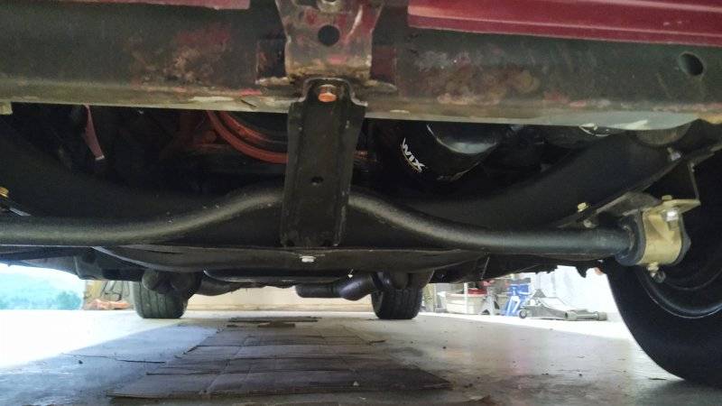

All that aside, this will mark the first time Fred has had the radiator support brace and the air shield in place:
(That radiator support took a LOT of "persuasion" in both torsional and horizontal planes to get the bolt in it).
Next step is obviously an attempt at getting some paint on some things...
poor grille support was some kind of mangled as well, too.

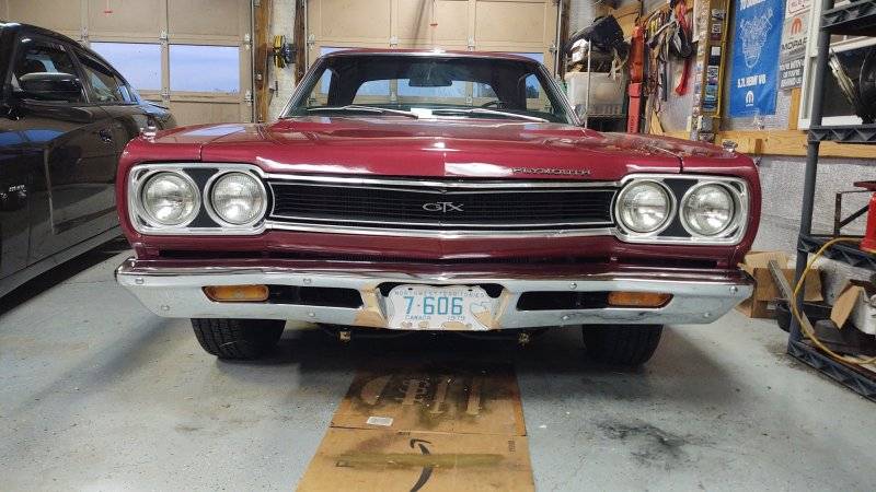

Not the optimal gap from side to side when seen from above. I know the bumper
is in the correct position (at least as judged off each fenders' side marker), so that leaves
the mangle factor of the air shield itself (a lot of pounding took place to make it "flat"
again for sure) as well as the poor radiator support.
At least the radiator appears equally parallel when used as a judge on it...
The bumper, not previously suspected of being crooked....now isn't.
Poor lightly damaged grille got a little attention, too - but honestly needs replaced someday.

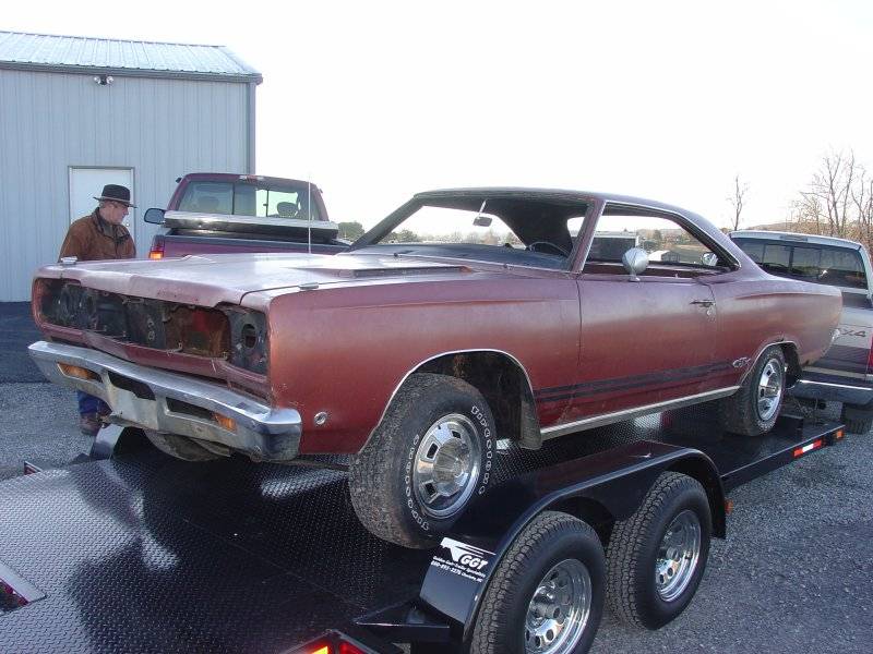

This is an actual pic of him from 2006, when he was dragged out of the field in SW Virginia by the previous owner.
That bumper is long gone, of course - but check out the factory blackout treatment behind the grille!
(Those are his original wheelcovers too, which I still have).
