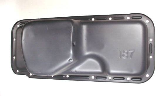

The 187 and 699 pans are very similar and have a shorter rear section with a relief made into the pan. I would assume its for the idler arm clearance.
