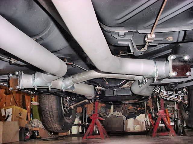

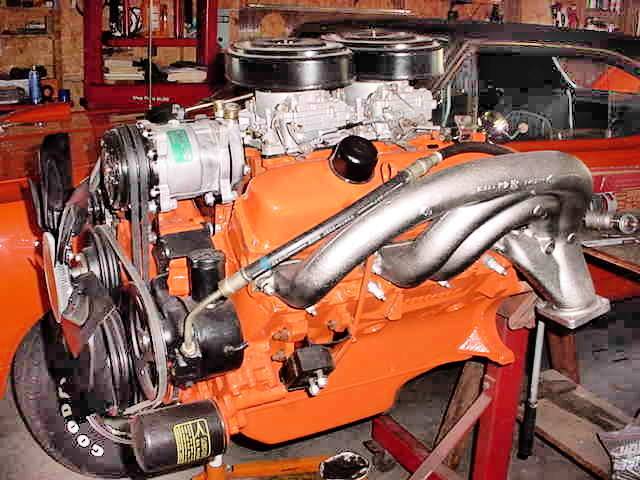

.925 bars here,7 leaf rear springs,Monroe gas shocks and power steering,started as a slant six stick,no drivability issues with whatsoever,rides as good as my bird.

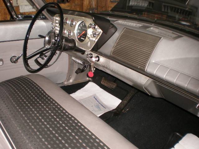

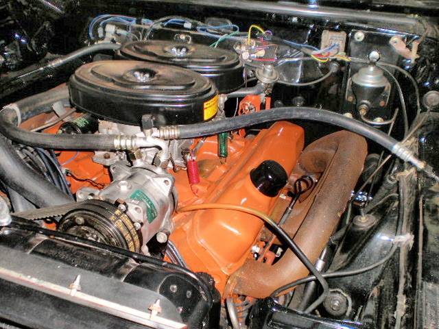

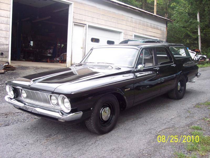

Actually it was white when I bought it,sold new to Kansas forest then went to Crawford Nebraska fire Dept.18,542 miles when I brought it home in 1997.A few pictures.
