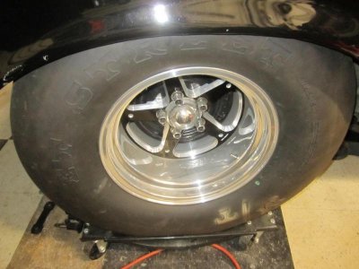

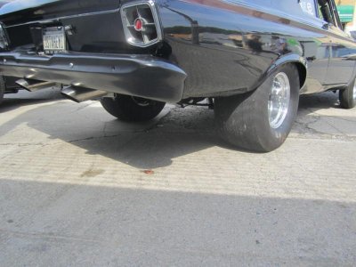

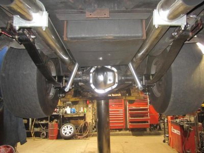

Have to wait 'till you have the car so you can measure it up.My 63 is mini tubbed with the wheel lip eliminated.The E/T streets are 16.5 X 31 on a 12 inch rim with 6 inch B/S.
Also keep in mind that Weld wheels are only available in 1 inch incriments.
