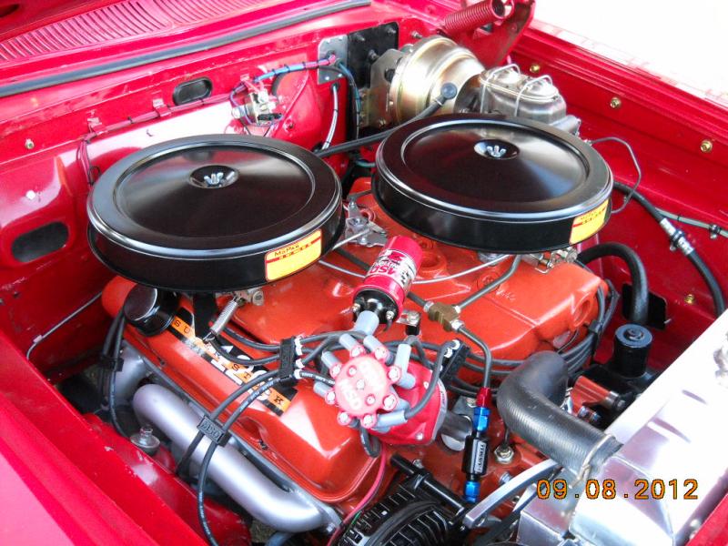

I'm running the Mancini/A&A cross ram with 600 Eddy's on my 440 (+.030) with no driveability issues--behaves beautifully in traffic. Absolutely no bog if you stab it--just pins you and readily returns to idle with no problems. I think if you have problems with your car behaving in traffic, it's probably due to your engine being more radical than mine--not necessarily the induction set-up. I'd go for it--there's no substitute for the "wow factor" when I open the hood.

nice :headbang: yup that has the wow factor :headbang:

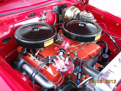

I run a 440 with maxwedge heads, a factory crossram with 2 Edelbrock 500s, slightly smaller cam, 4 speed and 3:91s in my daily driver. As ilm65 said, the car starts right up, idles well and is very responsive. Mileage usually is about 10-13mpg if I keep my foot out of it. Don't need to choke it unless it's pretty cold outside and may have to jazz the throttle a few times for a few minutes, but then it settles down to a nice idle. I also am 'old school' and love the 'jaw drops' when I open the hood. Correct tuning is everything to running this combination, but it's not hard. Good luck with your project.

Coloradodave, NICE JOB! I'm curious to know how well your car brakes with the power assist. I've hesitated putting one on my car, but yours does not take away from the max wedge appearance. Also, Budnicks mentioned that the Edelbrock RPM heads are nearly twice the price of Stealth heads--wasn't aware of this; I'm running the Edelbrock heads and as I recall, fully assembled out of the box, $1380 for the pair. I'm sure they've gone up since my build (2008) but I'd be curious to know the price on the equivalent Stealth heads.
If that was meant for me, thank you very much. I am in awe of ilm65's car!
As for the power brake set-up, it's a conversion to later Mopar single piston caliper disc brakes with stock rear drums. It brakes very well with 10" vacuum. No issues at all.
