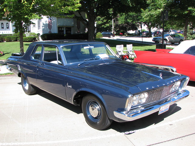

I have a 63 savoy that I'm building into a max wedge clone. Does anyone know what wheels would have been original to a factory max wedge car? The car is manual steering manual brakes if that makes any difference
Maximum Performance Dodge and Plymouth cars for 62-64 were equipped with 14X5.5K painted steel wheels, per my book written by Jim Schild. However on the same page he shows a picture of an original tire and wheel comb that was from a 1964 Maxi that is a 14X6.5. Soooooooooooooo I would say 14X6.5 because 5.5 is very skinny even for the time.
7.50x14 super cushion tires with black walls standard WW's were an option in the same size.
14x6.5 with 5 on 4.5 pattern? And what kind of hubcaps? This may be elementary but I've gotten mixed answers
You can buy them new, even Summit have them, small hub cap large bolt pattern, I like the 15x8 15x6 look.
http://www.summitracing.com/int/sea...50865+400230+4294920860+4294920795+4294920824
The 14 x 5.5 was standard. You could upgrade the rears to the 6.5". Wheelcovers or buttons were all available.
wheel part # 2084628
You can get the book for everything about max wedge cars from THE AUTO REVIEW.
the hub cap was the large 9 3/4". finding wheels for those caps may not be easy. they're not re-popped.
The correct 14" X 6.5" are rarer than hen's teeth. They were over the counter parts. They were standard on hearses and airport-type limos if anyone runs into those.
