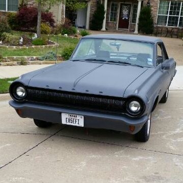

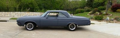

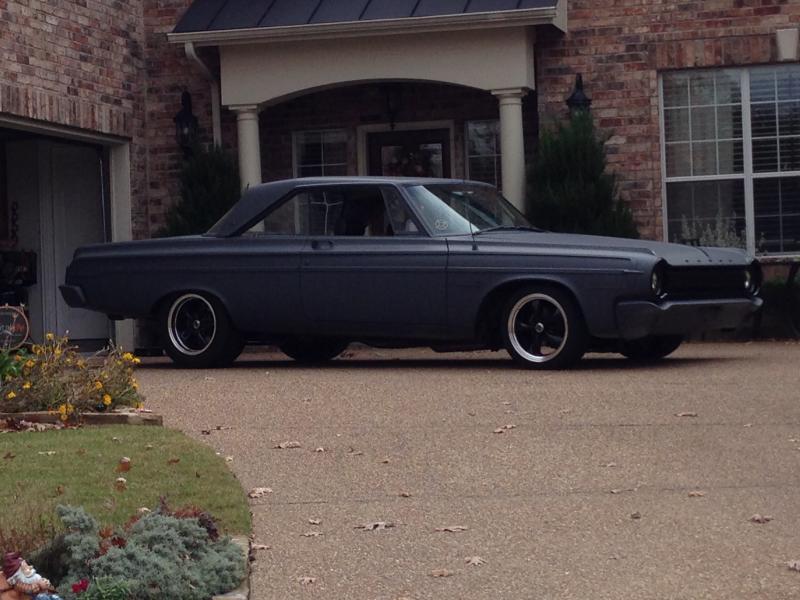

Here is a picture of what the car looks like right now.

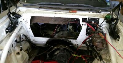

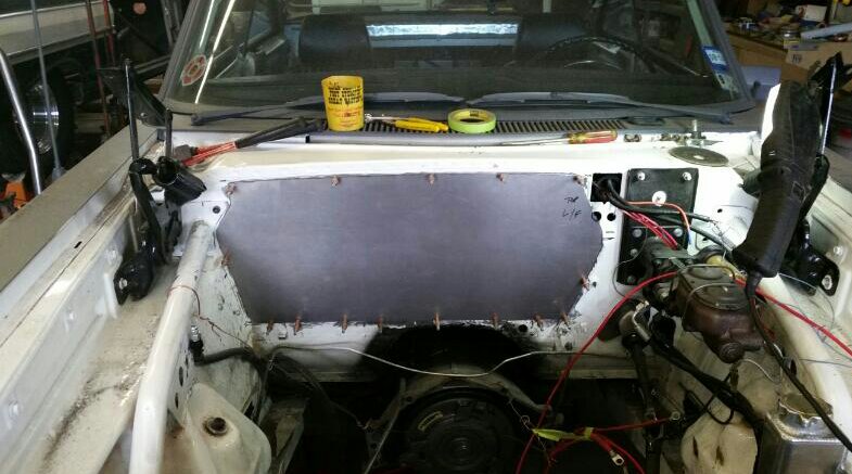

Well the cars headed back to the shop today I'll post pictures as I go. We are installing the 12 point cage and rear suspension setup starting this weekend. We are going to drop the motor in and start on the turbo fab work too.
Some other changes. After giving it lots of thought, I'm switching to the holley efi. One controller will do my efi, transm8ssion, and provide all the boost control i need.

Away we go
Posted via Topify on Android
Let's the cutting begin
