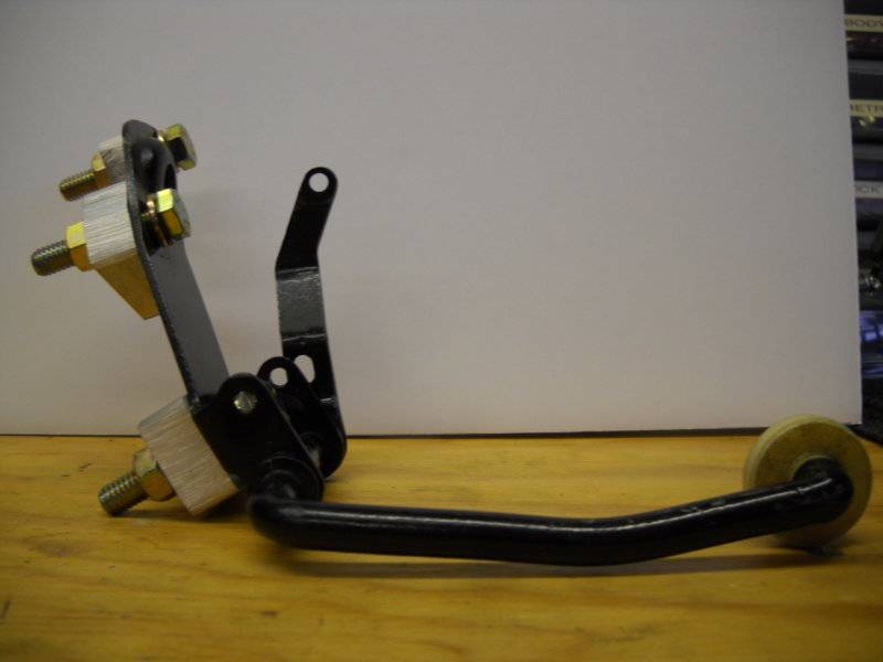

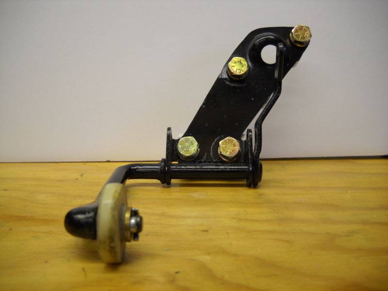

I have been using a Lokar cable on my 63 for 14 years since I put it on the road. When I was done I could not get full throttle even with the cable as tight as it could go. So I went inside the car and bent that rod that the pedal hits on with the roller on it as I bent it up for more pedal travel and that cured the problem and gave me full throttle. Its been like that for 14 years now. Ron
Agree with Ron. COLD bend the pedal. Worked for me...

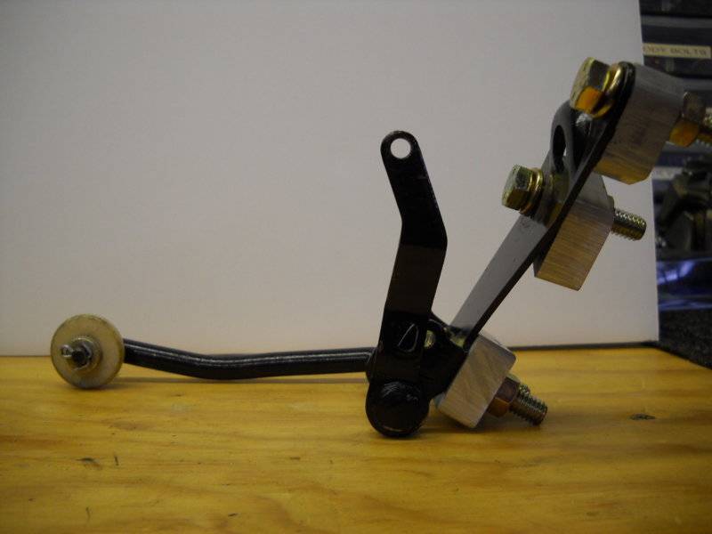

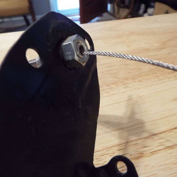

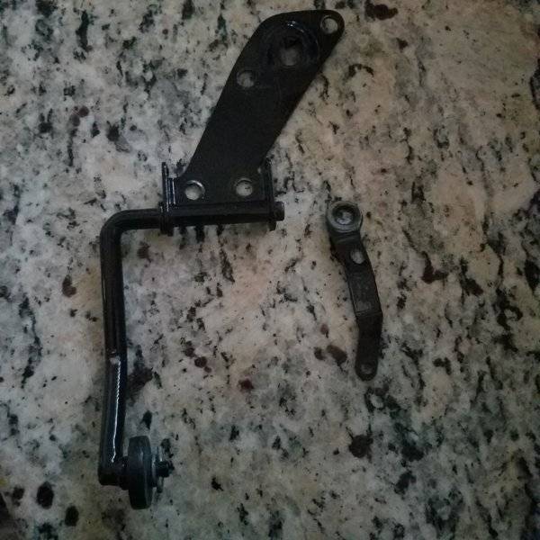

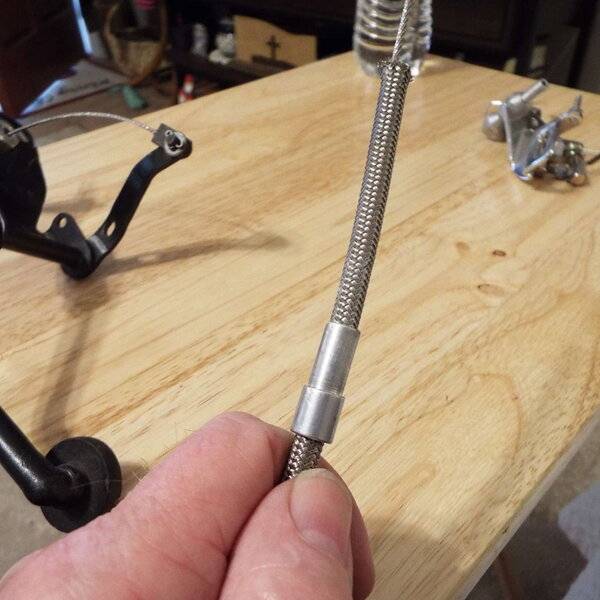

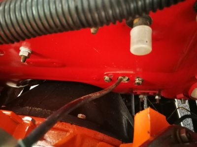

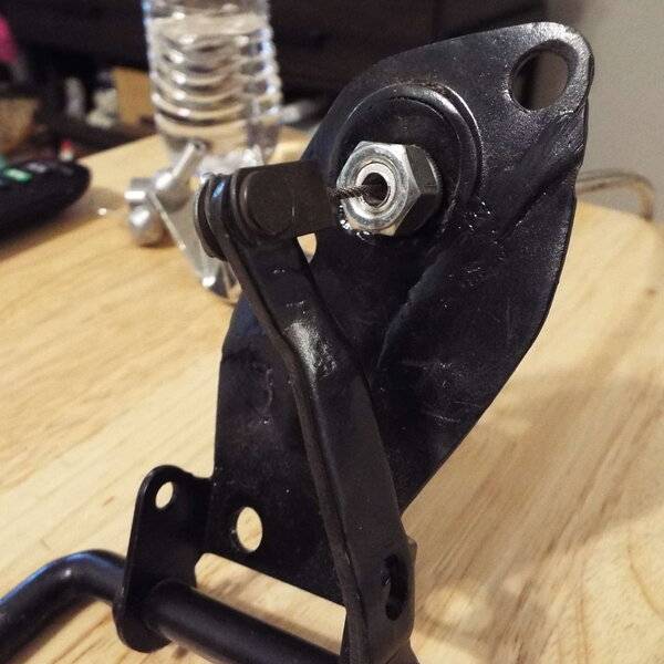

Thanks Guy's! I'm going to give bending this pedal linkage a shot and see where it gets me. Im still not even sure i have the right one in my car do you guys have any pictures of your pedal linakges and what years are your cars?
