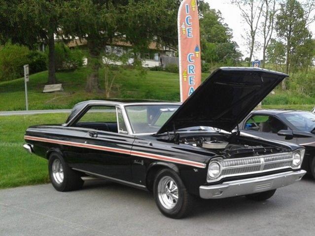

My Belvedere isn't charging. I replaced the alternator and the voltage regulator. I also have no dash lights. Any ideas as what to do next? 5-20-14 Dairy O cruise in - Cropped.jpg
It's beyond repair...
I'll take it off your hands for $7500
