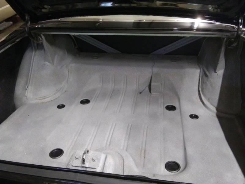

Got the trunk painted, rear wiring harness installed and new plugs.

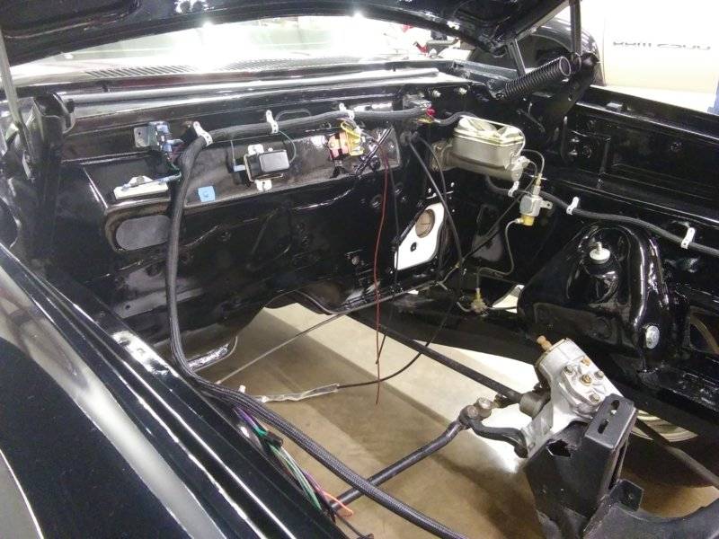

Finished building new front/engine wiring harness.
Hoping to get the engine and trans in next week.

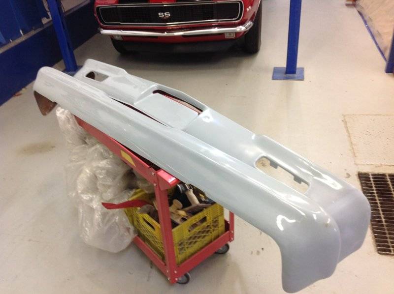

Anyone have first-hand knowledge of AAR/Stinger fiberglass front/rear bumpers?
View attachment 617404 View attachment 617405

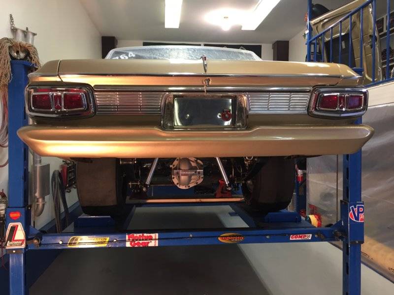

I got a pair from AAR, they were very nice! Minimal prep before painting. Shipping is 2 for 1 also. I'd buy them again in a heartbeat.
From AAR. Just out of the box (well packaged too)

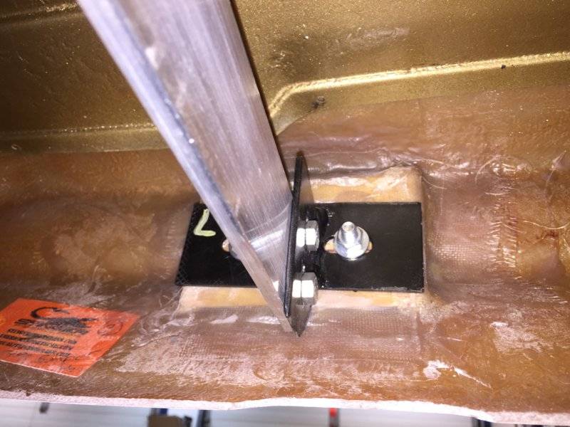

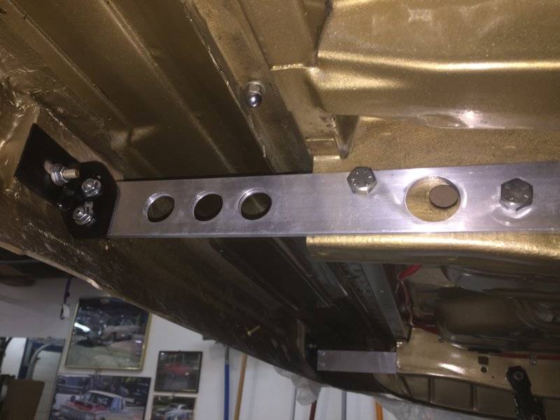

My rear bumper bracket. Escapulated plywood blocks with bolts pressed in from the back side.

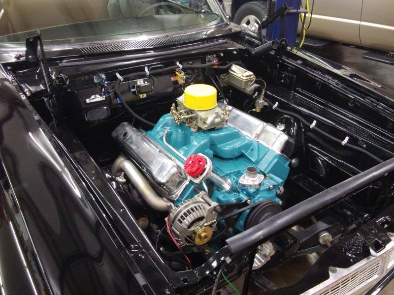

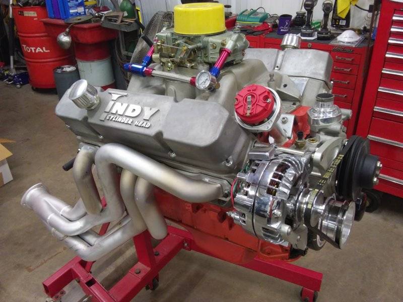

I'm changing valve covers to the stock looking 65' chrome ones. Only problem they may not clear the roller rockers. I'm hoping a set of thick cork valve cover gaskets will do the trick. The cost of aluminum spacers is crazy. Anyone know if the VHT brand engine paint is close to the original mopar turquoise?
493 cu. in.

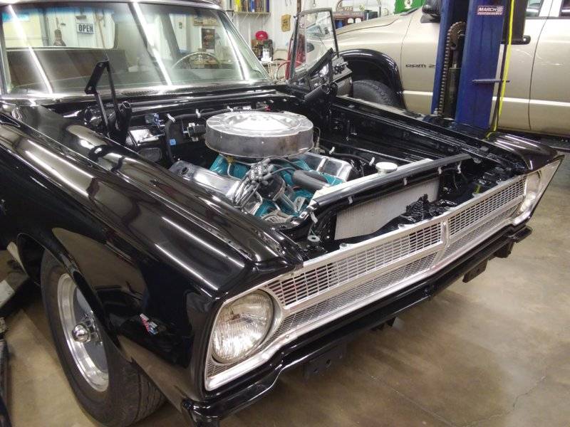

Finally got the engine in. Its a shame, a town of 100k+ you've got to order everything. Simple things like inverted flare tees, carb fittings, engine paint, even valve cover gaskets!!!!!! And they call themselves parts houses.
At any rate, the engine is in.
