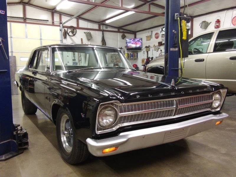

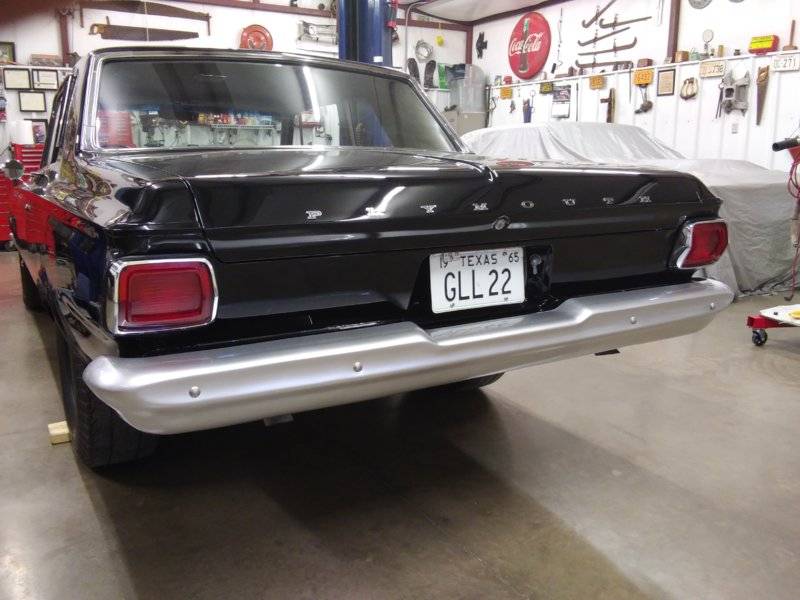

Not exactly chrome, but I think the AAR bumpers came out OK. Started installing the Legendary seat covers. Fit & finish is really nice.
What did you use for paint on the bumpers.. They look great
streetwedge did you use your standard bumper hangers. your project is looking great i like the color tone of the interior. going to make the exterior pop even more.
I used a Chromabase fine silver. Five coats of Nason clear.
I decided to use the stock bumper brackets. I know, heavy and bulky. But my reasoning was if I get the coins to have my steel bumpers rechromed in the future, it's just a matter of removing the glass ones and bolting on the original steel ones. I like what malex did with his, but I kinda wanted to keep the stock, sleeper look.

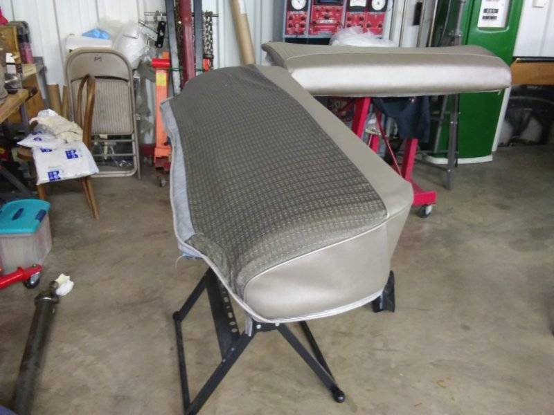

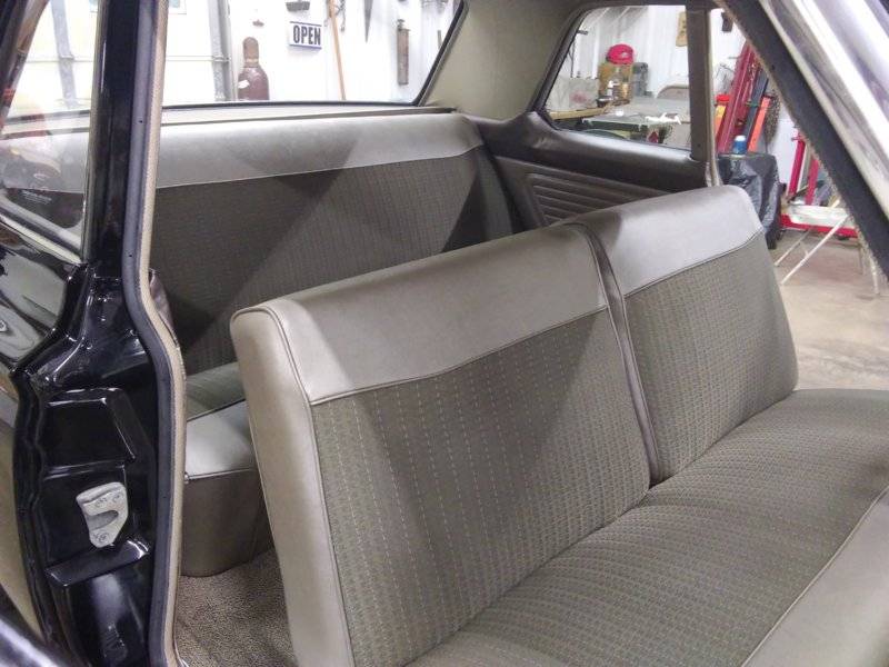

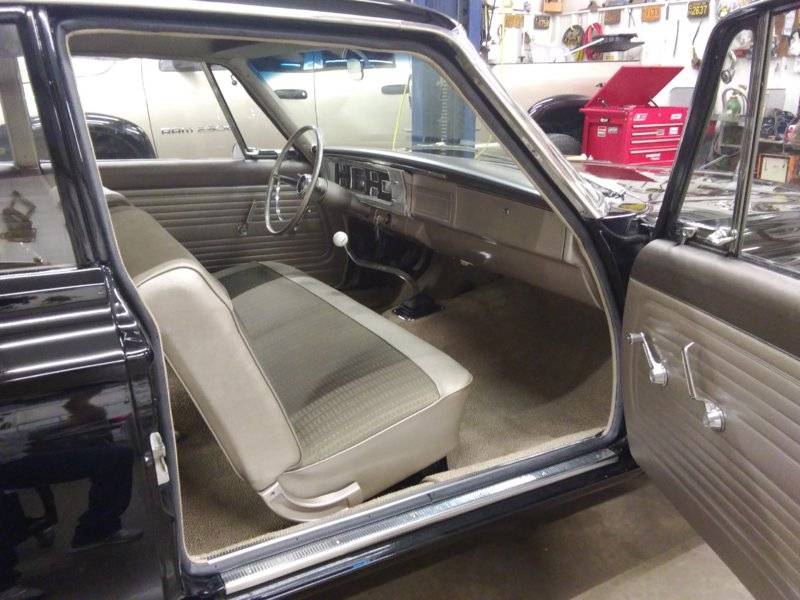

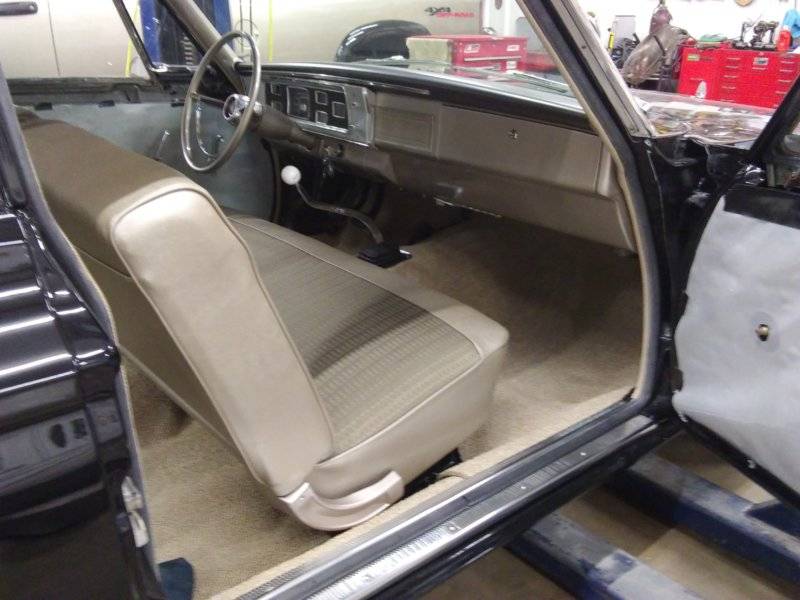

Finished the seats today. Front seat was a b--ch. Had to completely rebuild it. Foam turned to dust and had to replaced two springs. At any rate, they're done.

its looking really nice the color combo is great. leave the glass bumpers makes people think about it. yep the waiting game on parts suck but it's what it is. enjoy your ride again looks great

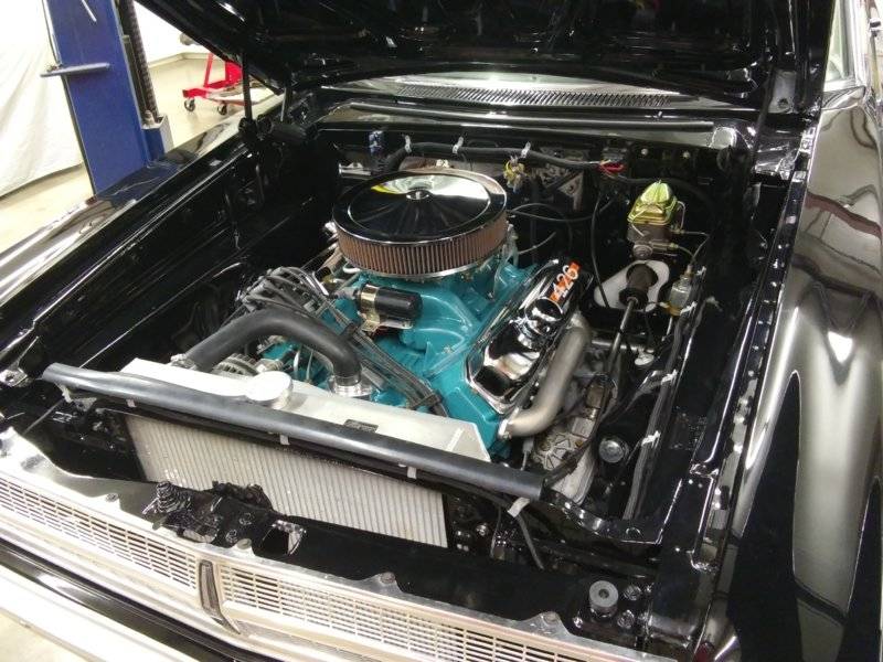

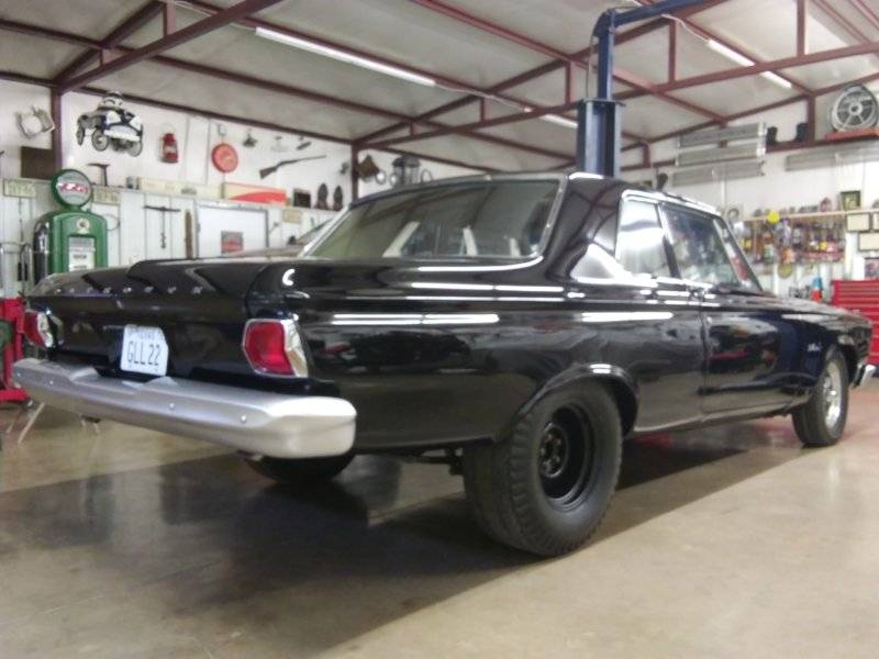

Well, she's done. Other than tweeking the carburetor. Seems the air/fuel mixture screws aren't doing much. All four are closed and still ldles fine. Maybe a vacuum leak? Maybe secondaries are cracked open?
20180830_143248.jpg 20180824_150605.jpg 20180824_150210.jpg 20180904_190456.jpg
i want to say it looks awesome, your ride looks like one strong street fighter and ready for some track duty. enjoy the music of those pipes and the great smell of peeling asphalt. truly a nice ride
