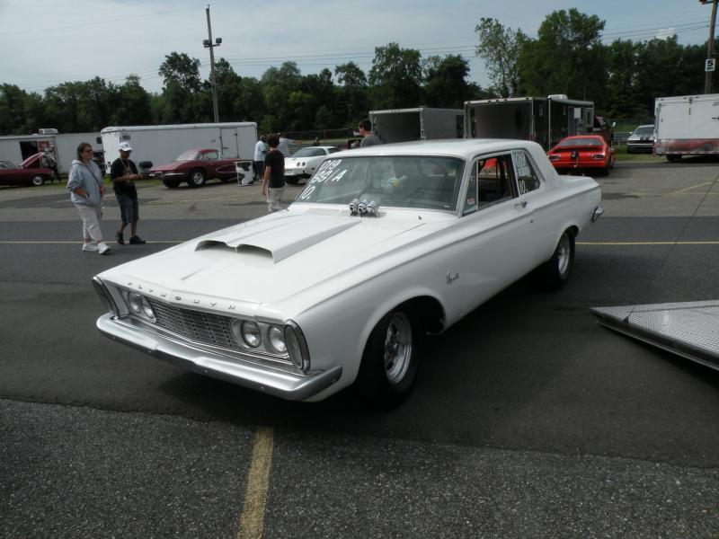

hate to tell you but those shocks are the worst out there. I am taking them off of my 63 Plymouth and replacing them with afco dbl. adjustables.
those shocks don't work worth a crap. I hate them. my front end does weird things too with them on.
