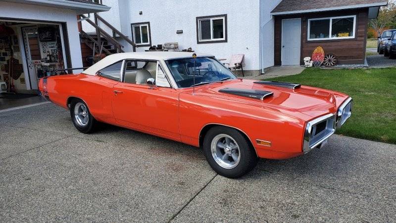

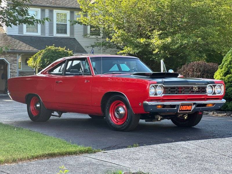

I've got 235/70x15s on the front of my 69 rr, on 6" steelies.
what brand/model tires Front and Rear? I don't often see that size. Looks great!
Thank you!
33 IMP is correct. The rears are Mickey Thompson ET Street SS Drag radials. The front are an older set of firestones that I will be replacing over the winter. I won't drive one of these older cars with power on anything but drag radials. I don't worry about the car going sideways or kicking out when I hammer it, when I romp on it they hook great.

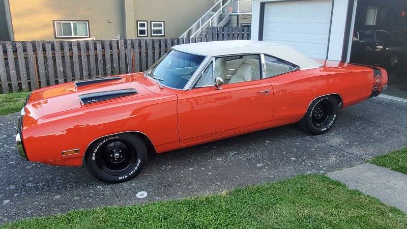

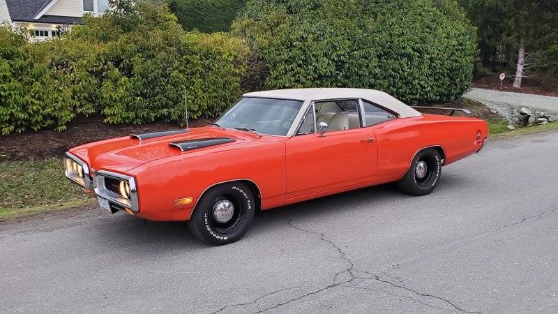

nice! the sidewalls don't bulge too much on those BFG's on 8" rims. Which FRONT TIRES do you have on there? 245 60? or even 255 60s'.. those look ideal to me.. somehow the sidewalls don't even bulge much more than the 295 50's on the back
There are 275/60T15s front and rear

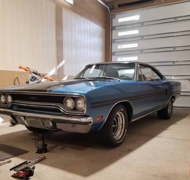

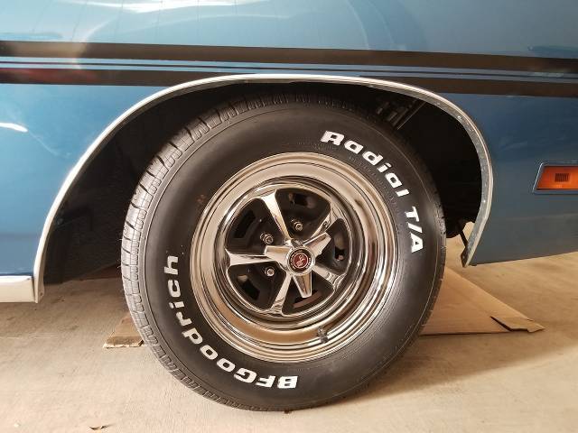

just had some BFG's installed on my magnum 15" wheels (and pretty sure 8" wide, will verify tomorrow).
We went 275/60/15 rear, and 235/60/15 front, but I think the front needs to come up a tad (adjust the height with the bolts under the control arms) but the 235/60's look a bit small? Have a pair of 255/60/15's we were gonna use on the rear if new leaf springs didn't lift enough to not worry about rubbing.. but what do you think about 255/60/15 FRONT, or should i just send the 255's back and get a pair of 245/60/15?

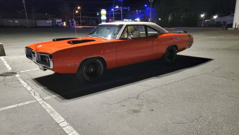

so have the shop ordering a pair of 255/60 15's for the front (replacing the 235/60s on there now in earlier photos) to go with the 275 60 rears on there in my earlier photos. love the wide fronts, like the G60 polyglass i took off that are basically 245 60 15's. The 255's will be tad wider and a tad taller.
Wanted to get a 10" pair of mag 500 wheels to put 295 50's on for the rear, but Summit has none i stock and doesn't know when they will get em. Could have put 295 50's on the 8" mag 500s i have but if im gonna toss all the money at ANOTHER set of tires, trying to get the right look, i wanted to get the best wheel for the tires too. 8" would work as many have done, and may go to it if still not satisfied with the 275/60 - 255/60 combo. Will post some pics when done.

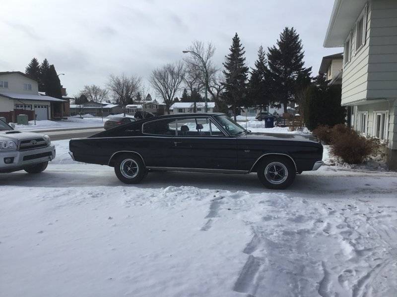

275x60x15 TA’s on the back. 225x70x15 on the front. 4.5 backspace
Car is on a slight upward slope.

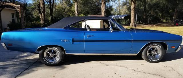

Personal preference here. One inch truck leaf from Summit inserted each side. Handles well. Sweet on freeway. Sunny and 65 here today. Box tips are in factory correct position.
