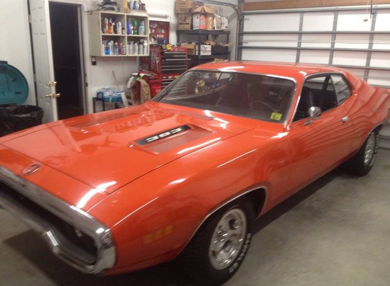

Just wondering what the combo's are for a 72 gtx. Going with steel mopar rallye wheels. I was leaning towards 15x6 in the front, 15x7 rear.
In other body styles, I've run a 235/60 up front, or a 225/70. Rears 255/60 or 275/60.
Whatcha running?
