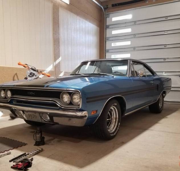

best tire combo? 275/60/15 rear.. 235/60/15 looks short for front.

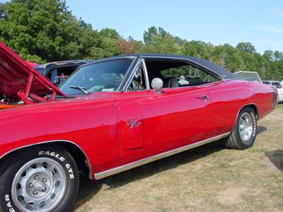

Dennis, aren't your rear wheels wider than 8"? I know you did some careful measurements for backspacing if I recall.
Dennis' car is a Dodge. OP's is a Plymouth. The rear wheel arches on the Plymouth are lower and could make it fit differently unless some inner trimming is involved...

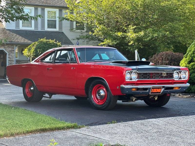

IMO, 295/55/15 is the sweet spot. They are the same height as the 275/60/15 and fit on an 8" rim. I am running the 295/55/15 in the rear and 225/70/15 up front.

nice.. may have to sell the new 275/60's for a loss, and get the 295 50's. will see.
295/50's are a little wide for an 8" rim. For what it's worth, 295/50's on a 10" rim and 235/60's on an 8" rim are a widely accepted matching pair. The sidewall bulge and proportions just look right, the 295 is about a 1/2" taller than the 235. If you go any taller than a 245/60 or a 205/70 your front tire will be taller than a 295/50.

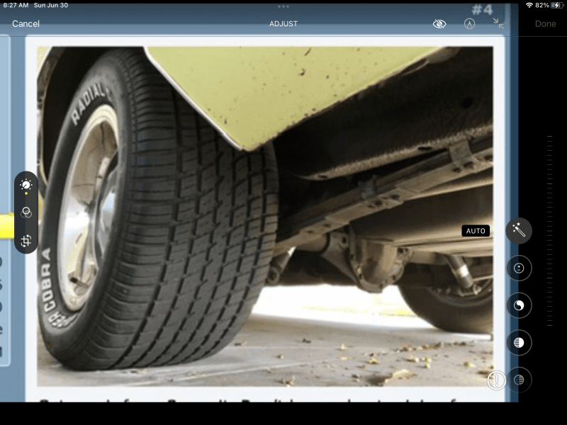

Summit order can’t be found. I ordered 15” Rallyes with Coopers mounted and didn’t specify width IIRC. No backspacing mentioned or an issue.

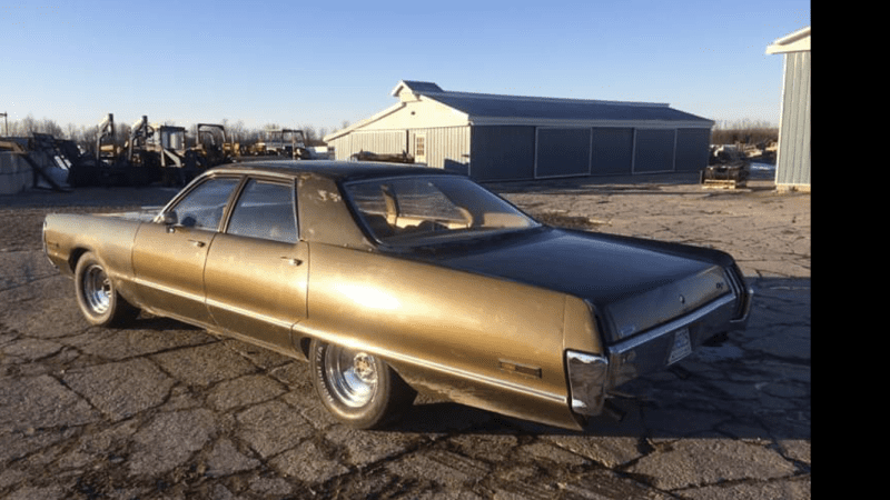

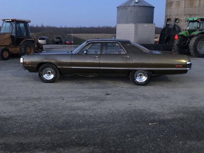

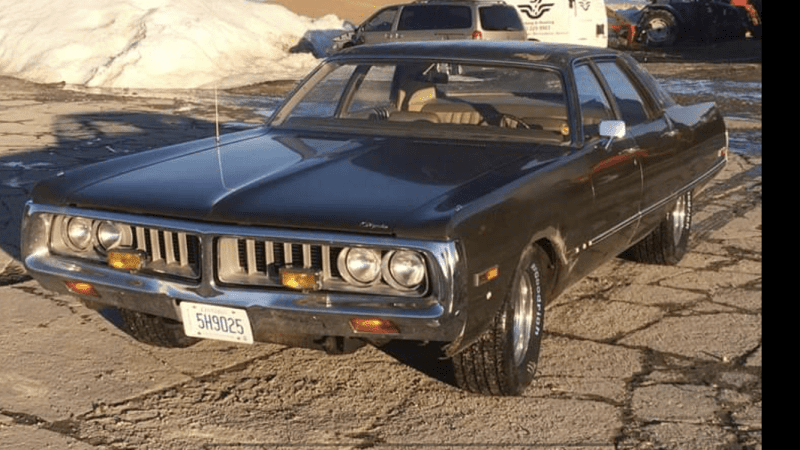

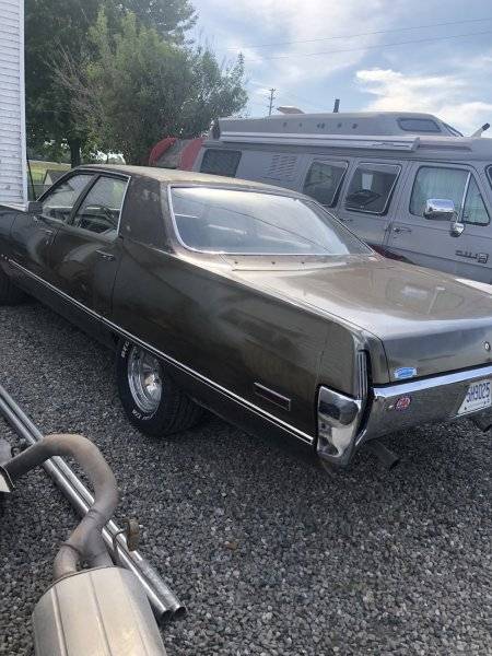

All the talk of 275/60R15s made me want to share my former 72 Newport on 4 275s. Think those wheels were 8", it rubbed on the rear with a load, I put another leaf in the back and a 9.25 diff from an 81 Gran Fury that was about 1.5" narrower.

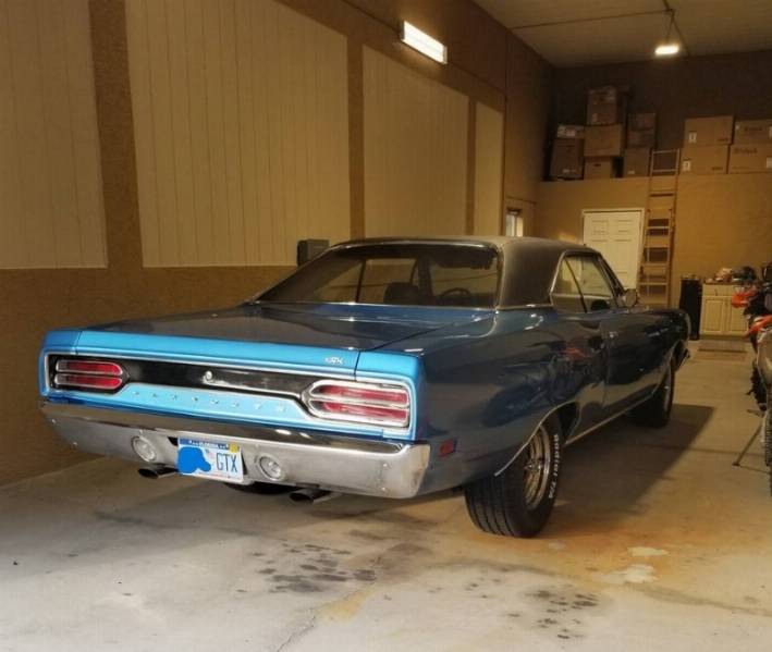

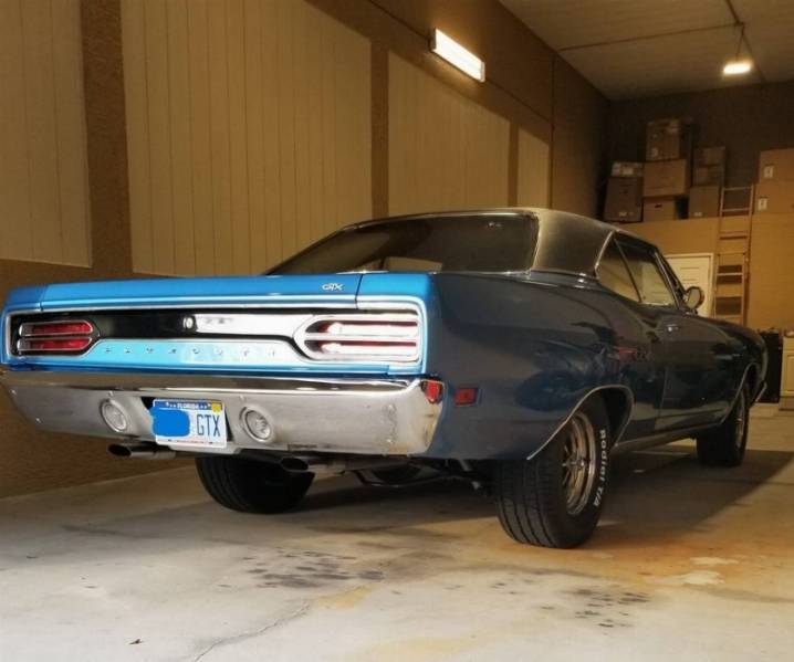

nice! the sidewalls don't bulge too much on those BFG's on 8" rims. Which FRONT TIRES do you have on there? 245 60? or even 255 60s'.. those look ideal to me.. somehow the sidewalls don't even bulge much more than the 295 50's on the back
I don’t understand the “bulge” comment regarding a smaller rim. Sure, the look is a little different for different rim widths, but it’s small. The tire cross section is smaller with a narrower rim. For a 1” smaller rim there is a 1/4” less bulge from tread to max cross section width, and a 1/4” more bulge from rim to cross section width.
You are giving up nothing meaningful going with a rim width that’s in the manufacturers accepted range.
For 50 years I’ve always run the smallest rim recommended for a tire size and even smaller a few times. I personally prefer the less rim width look. Tire performance has always been fine.

when i was saying "bulge" (and maybe others mean it same way), i was meaning the wider the tread on the same rim, the tire tread and sidewall protrude out further from the rim.. can keep going, to a point. As you said, if within the mfgs accepted range, shouldn't be an issue. Personally, i'd love a 295 50 on my 15x8 rear rims, just having never done it, i'm having a tough time getting on board with them on an 8" when i was gonna put them on 10" rims for a 67 chevelle i just bought.
