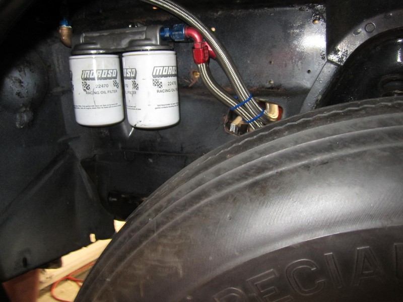

I put a dual remote filter in the left front wheelwell with the hoses going through the exsisting opening covered by the rubber flap.:headbang:

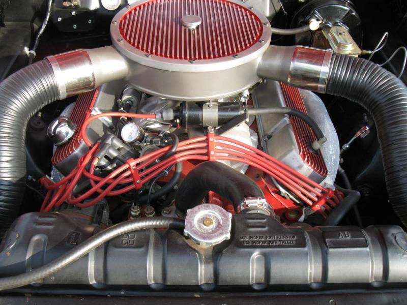

Nice, great spot, but rooked again that is where my air filters are. I am leaning towards mouting in front of the exsisting filter but then it is quite visable under the bumper..might look cool ...might not *G*
