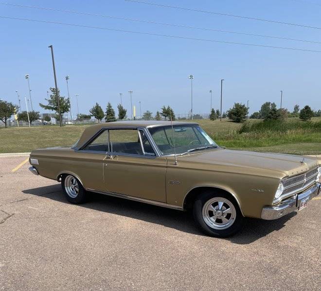

65 Satellite needs a brake booster. Has a rebuilt Midland style booster with the original style single master cylinder. Looking at upgrading to a newer booster and master cylinder. There seem to be some options. Is this a good time to upgrade to front disc also? There are some reasonably priced kits out there. Not concerned about staying original. Just want a good working system.
Some of the boosters I’ve checked on only work to replace a factory manual system.
What are your experiences?
