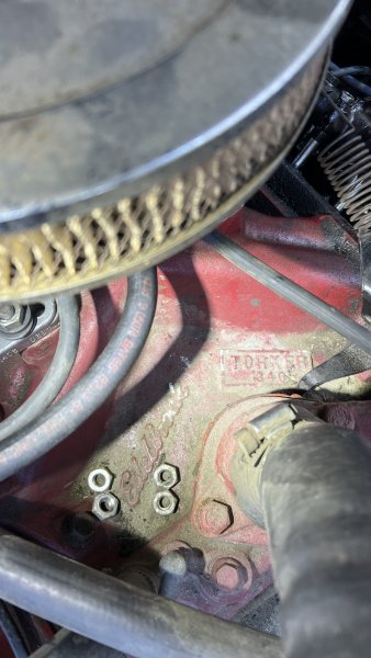

When I removed the valve covers and I got the head casting numbers off both heads which are 315-2. Seem like they are leftovers from 65??
The reason Im asking is I know the angle on the intake for 64-65 315s are different. The previous owner put an edelbrock 340 torker intake and 4 barrel on this car. Will this not fit correctly because of the 315 heads or did mopar change the bolt and intake angle of the 315s for 1966 leftovers?
Im confused what to do. I dont know if the intake is vacuum leaking because the angle is off. Im not even sure how much the angle should be off or not either. It doesn't look there theres a massive gap going on between the intake and the head. Or maybe the intake runners are too big to let it idle. No clue.

Carb is newly rebuild. I checked timing but its hard to check timing when the idle is high. Its pretty close to 10 degrees, but hard to tell exactly. Im tempted to pull the intake to see whats going on under there. From what I can tell it doesnt look like they used a gasket. It just looks like rtv sealer.
Ill check the bolt sizes.
The intake bolts take a 9/16 socket. They all looked to be mounted flush too, noting is on an angle. I guess even though these heads say 315-2 they must be machined by mopar to fit the newer style intakes?

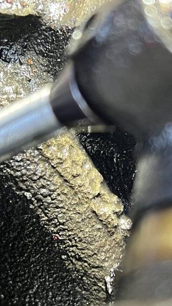

Id still be curious to pull the intake off and see what they did about the runners and if theres even a gasket between the manifold and the heads. Kind of a pain that the water passes through it.
Pulled the intake and it has the metal gaskets. Ordered some Fel Pros. The alignment of the intake runners to the head isnt perfect but it isnt the worst. Just gonna stick it back on and deal with the loss of torque. Im going to swap the motor out eventually anyways. Should be fine till then.
