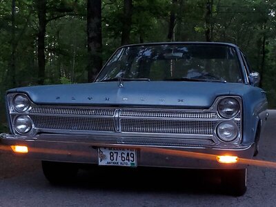

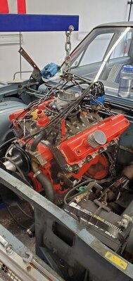

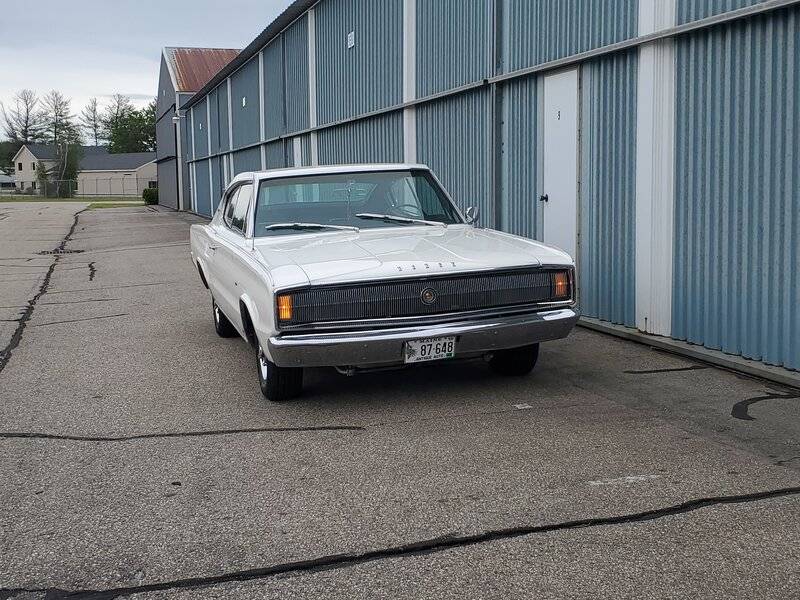

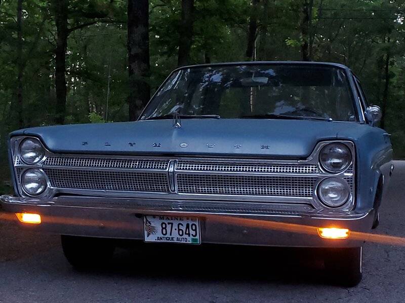

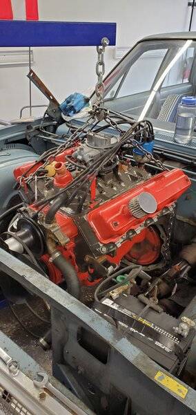

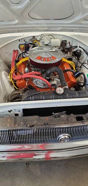

That's what i have heard, I can get my hands on a stock 4bbl dual plane for around $500 I have the stock 2bbl intake and can get holley 2bbl 500 for around $185-$200 which would definitely wake it up. There is definitely options I have available but wasn't sure if I was able to make it a bit better with what was on there right now. I'll keep yall posted on what I decide. For now, here are some photos of the Fury and the Charger, red with cast color engine is the Fury and orange with the weiand is the charger
