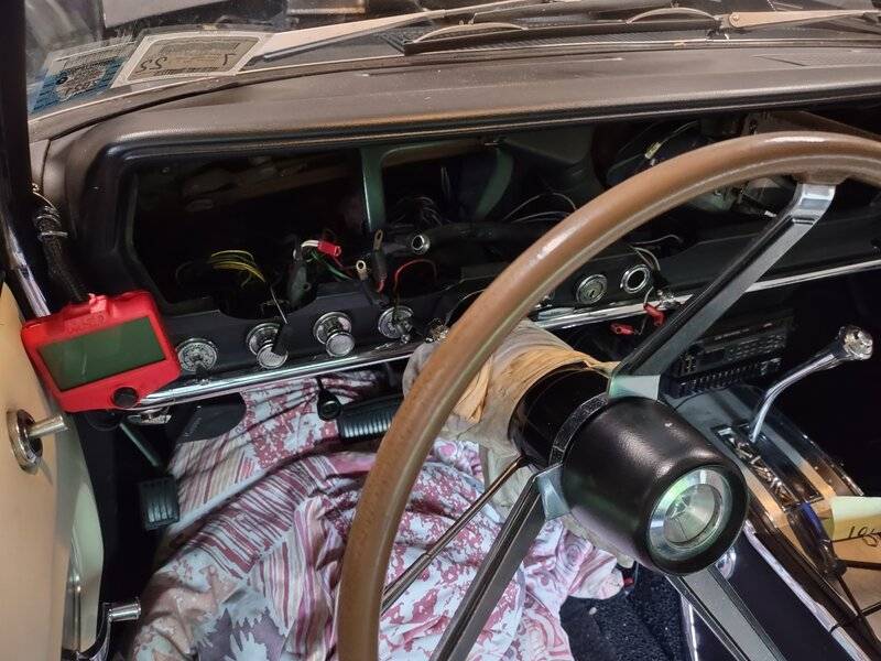

The past few days took the gauge cluster out since the voltage limiter must have been stuck last week on the way to work. My gauges pegged and it burned the wire off on the temperature gauge.
The fuel gauge and oil pressure gauge came back on later.
I ordered several things that same day. A new voltage limiter, a tachometer board and a new power pack for the electroluminescent dash lights.
I took the fuel gauge apart and disabled the limiter inside. Added the new one externally. Made a quick repair on the temperature gauge but it doesn't look really good.
I installed everything today with my son's help as I had a tough time seeing anything. But the gauges do work. The tach has mechanical issues with the indicator. I messed around driving it full scale and then bumping the cluster until it returned. Some improvement but it's still pretty sticky I haven't used it for at least 6 years is so since I put the MSD stuff on it.

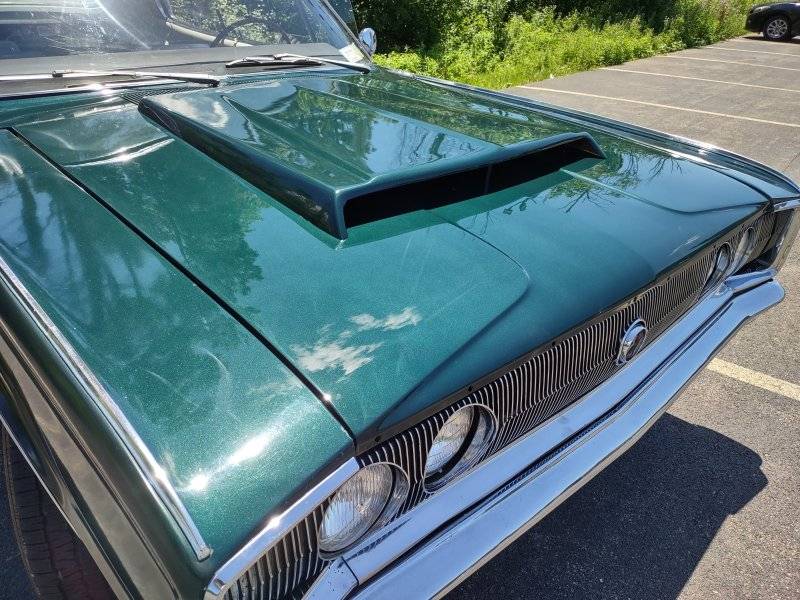

June 20th the hood goes in to get painted.
Hopefully fitting the hood scoop on this weekend.

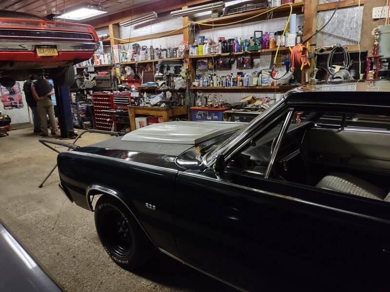

Had our "garage night" tonight at my friend's.
My son helped me get the scoop mounted.
Carl was working on the Ford.

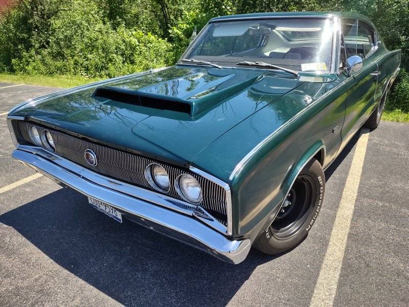

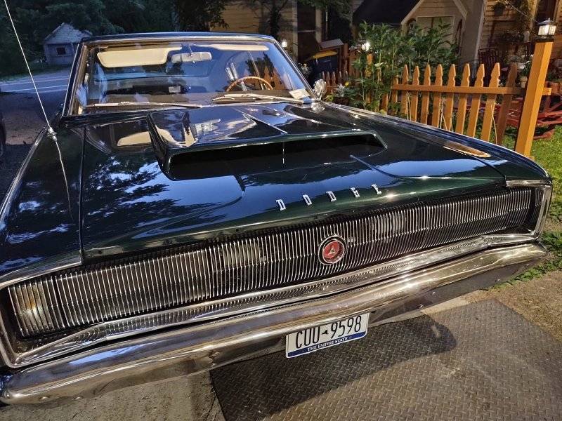

Hood is back on and painted looks really good.
Needs a little adjustment for height and gaps but I like it.

Hood letters on, need to steal the trim off the other hood.
These are OER reproduction letters and they are surprisingly good quality just like the originals maybe even better.

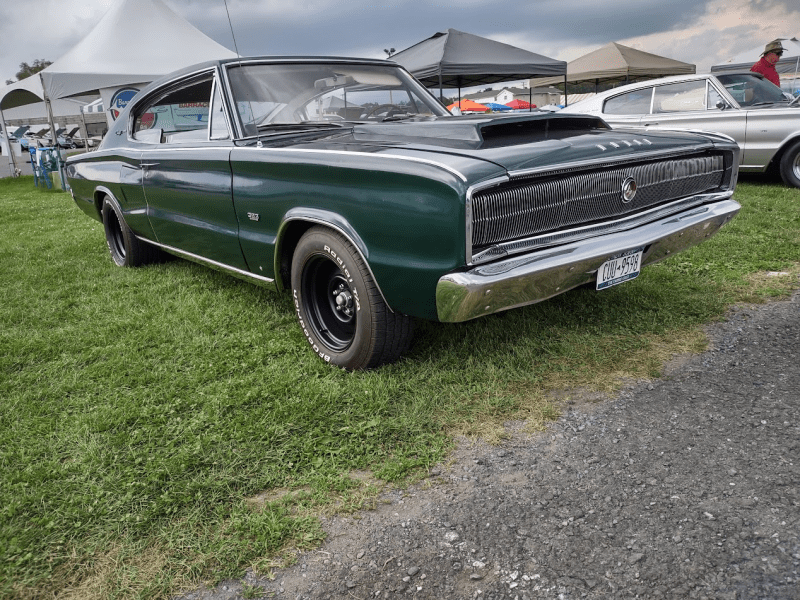

Had a great trip to Carlisle.
The car ran perfectly the only thing that cropped up was the vacuum line for the fuel regulator popped off some time Saturday.

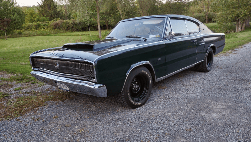

It was sunny and fairly warm today.
It rained hard last night so the roads were washed off from the last salting.
Couldn't wait any longer.
Went over and uncovered the Charger, hooked up the battery and fired it up.
That is always a good feeling becuase I know in a few months it will be "car season".

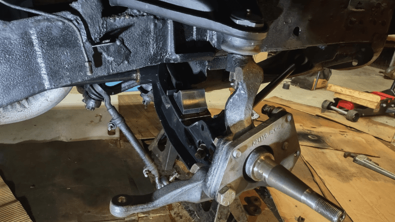

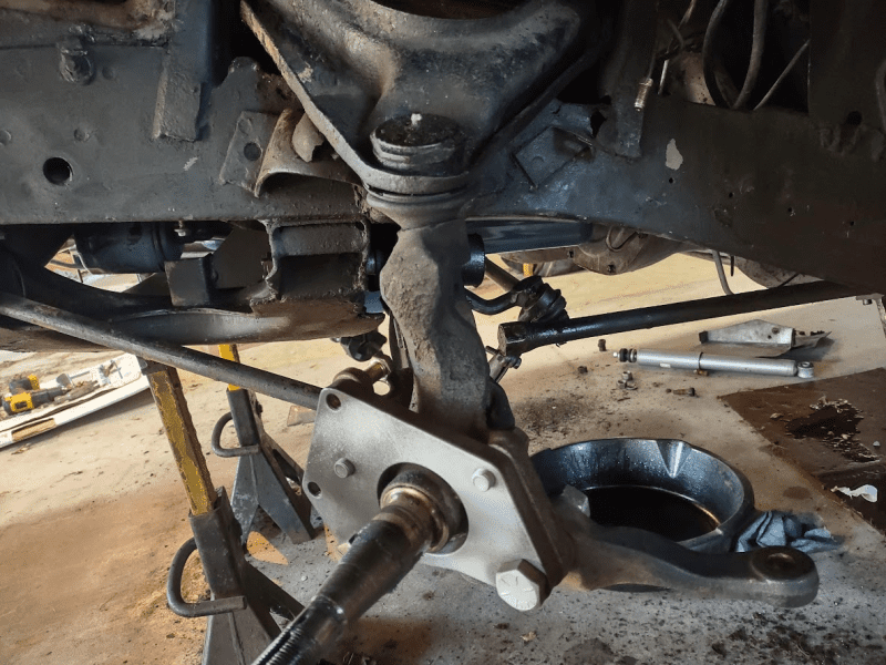

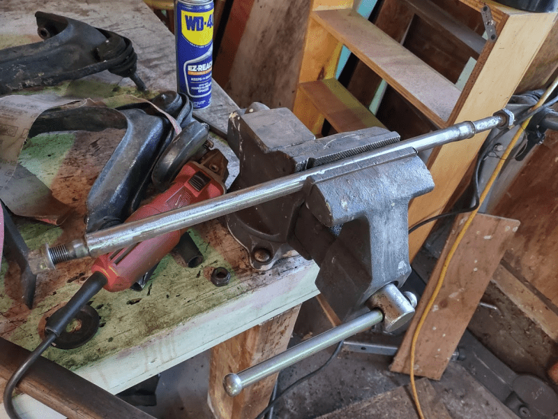

I put new torsion bars and rebuilt the front suspsension.
Most of the mechanical parts were still good from 1989 (only maybe 40,000 miles on them).

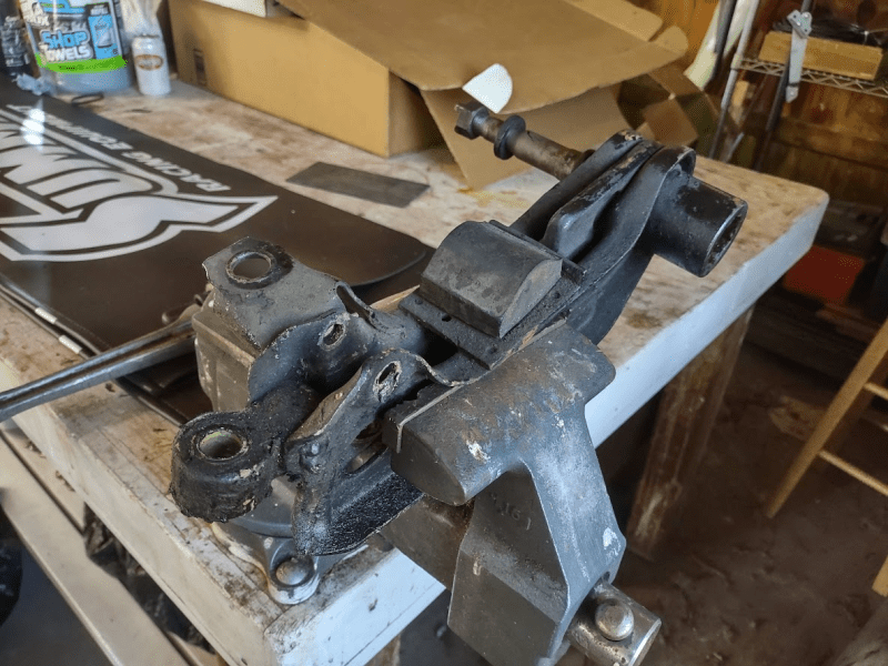

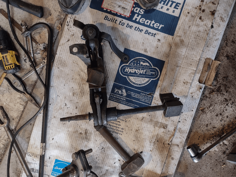

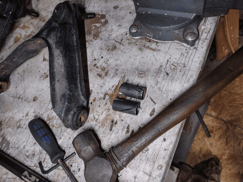

The passenger side lower control arm was seized. Had to cut the bar to get it to come out.
I cleaned up the strut rods and sway bar
Then we took a trip to Ireland for 2 weeks.
Afterwards I had to do a couple things on the Satellite to get ready for Carlisle so the project stalled.

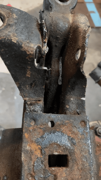

I did get the lower control arm freed up on the passenger side but it was pretty loose.
So I cut the tab off and welded it to my original from the Plymouth.
