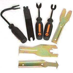

If your removing the trim around your windows buy a removal tool.
Looks like the one at the very bottom of the picture
The fender trim varies depending on location, the rear J moldings are held on by nuts inside the trunk, the rear fender trim is held down by clips that can be poped loose with a putty knife. Doors have nuts at each end and clips in the middle as well as the front fender trim. Take your time and you will figure it out.
