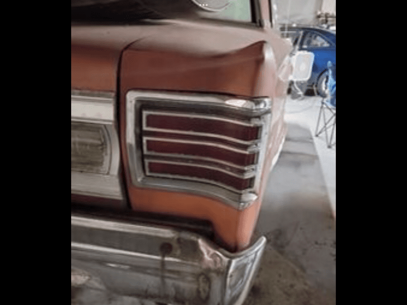

Here is a 66 car with a 67 lid and panel. Check the differences. See how much smaller the 66 light are. You will need to cut the holes on the quarter panels bigger for the 67 tail lamps.

So rear is taillights, quarter extensions, trunk lid and will need to cut openings bigger and drill holes to mount the taillights.

Tail lights and associated body buckets/quarter extension hsgs
Have both 66 and 67......wonder if you can interchange the 67 taillight surround along with a 1967 light on 1966....?
I bet you have to drill new holes to mount the lamp. You will need to cut the square bigger in the quarter for the lamp to go in. Smaller hole on a 66. But it will work with some measuring and cutting.
