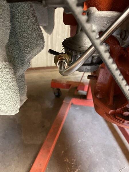

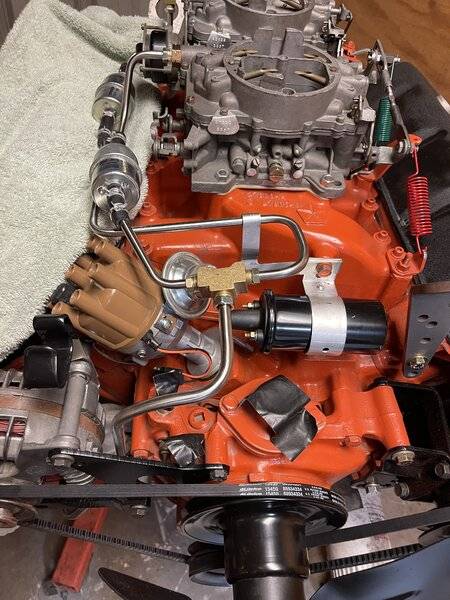

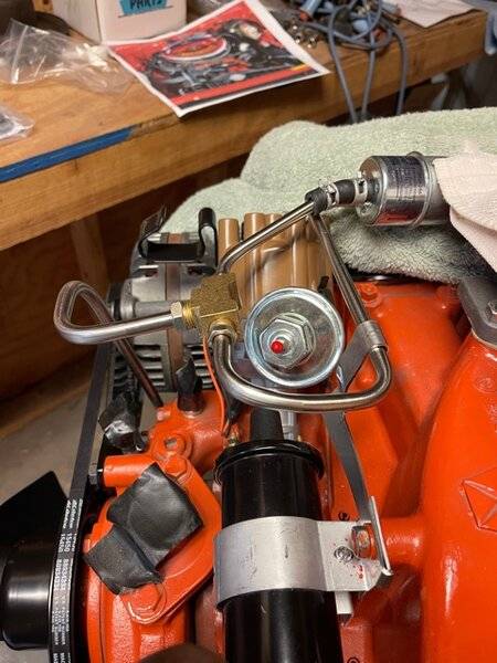

I installed my fuel lines after I increased the bend on the line to fit the "T" in the prependicular position, so my fuel line from the fuel pump would line up. I also shortened the rubber connector hose on the line to the front carb. It is all secure and completed. See photos.
Fuel line bend.JPG fuel line to fuel pump with 45 degree fitting.JPG Fuel lines installed.JPG
Looks better. Is this an OEM restoration, looks like your sticking to original. I do have a restored Hemi fuel pump. Getting rid of the 45 deg fitting which does hurt flow some, would help alignment of the first 3/8" line and Tee.
This is my first Hemi Charger restoration and yes I am trying to get everything correct. Thanks for the offer on the fuel pump but now that I just got the fuel lines finally installed I would like to get it back in the car and see it running. Send me a PM with a price you want for your fuel pump and I will give it some thought. Thank you.

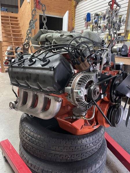

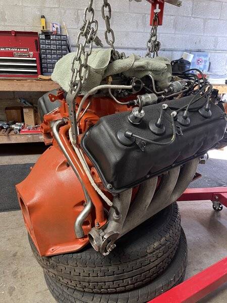

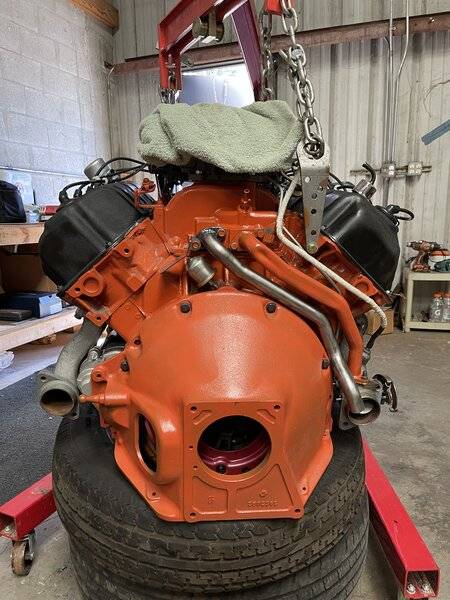

I am ready to istall the engine in the car this Saturday, finished dressing the engine last week and installed flywheel, clutch, pressure plate and bellhousing.
