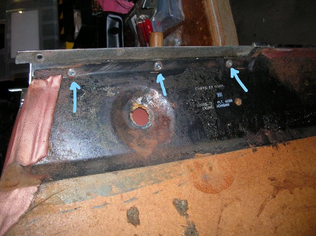

I need to remove these rivets on the front door panel to remove the trim so the door panel can be cleaned and painted. If I drill out these rivets are they replaceable or once removed there is no way to re-attach the "CHARGER" trim?

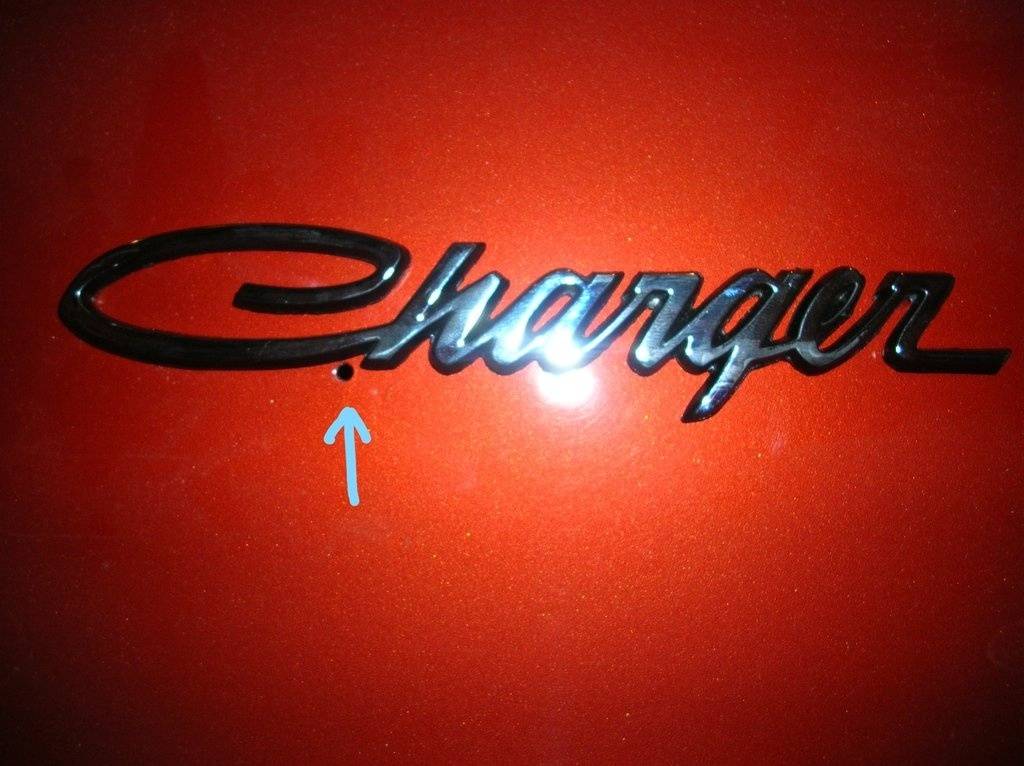

and one last note...while replacing the sail panel emblems, the lower hole on the right side of the cars sail panel is in the wrong location...this is a factory hole. I disassembled this car in 2002 so I do not remember how it looked originally. Maybe it was filled as the car had been re-painted. Has anyone seen this before?

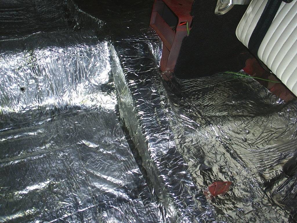

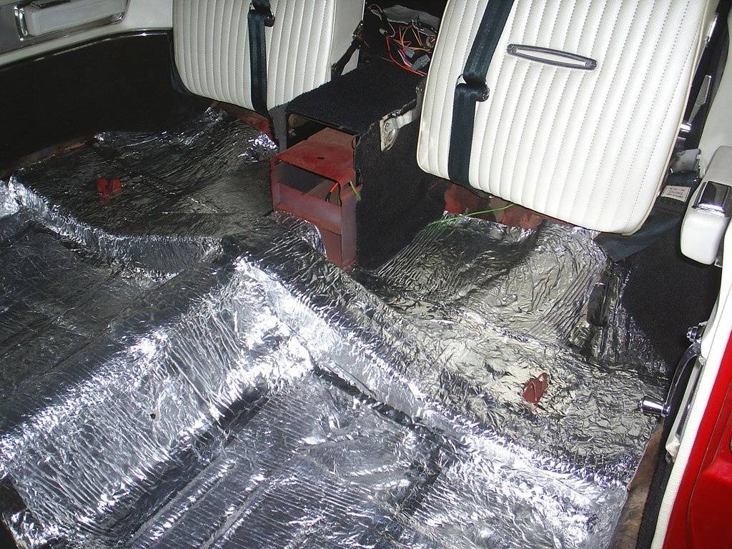

Well, lets see. First I will have to go look or find a picture of my back seats.
Second, once the rivits are gone you will most likely have to glue the trim on. I had to do that with the "Charger" trim above the mirror adjuster on the driver front door. Not sure about the back though as I cant reall tell from the picture what it is.

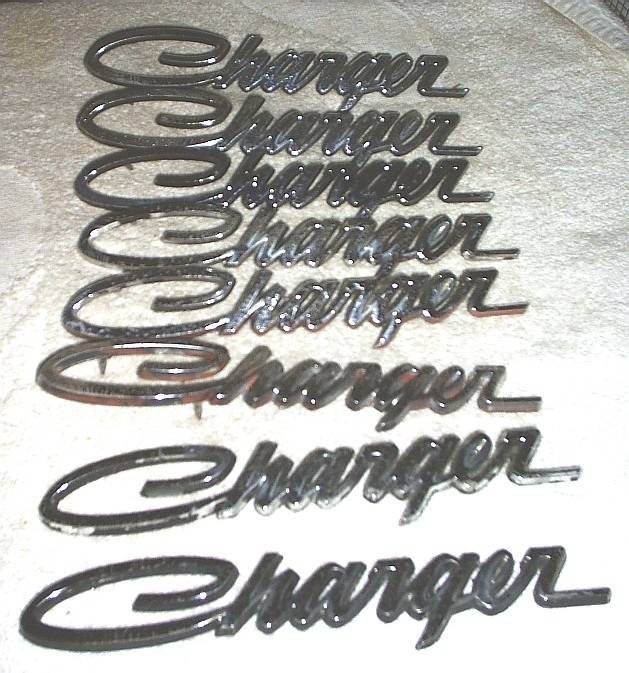

The replacement "Charger" script only has 2 pins but the original ones to our cars had 3 pins. If it is straight, it's correct. Just fill the hole. Don't forget the arrow always points front.
Now that I look at the picture again, that is the same panel, yes, you will probably have to glue it UNLESS you get remove just enough the have a nib the put a small nut on.
