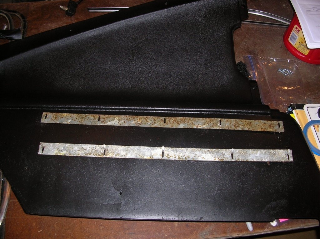

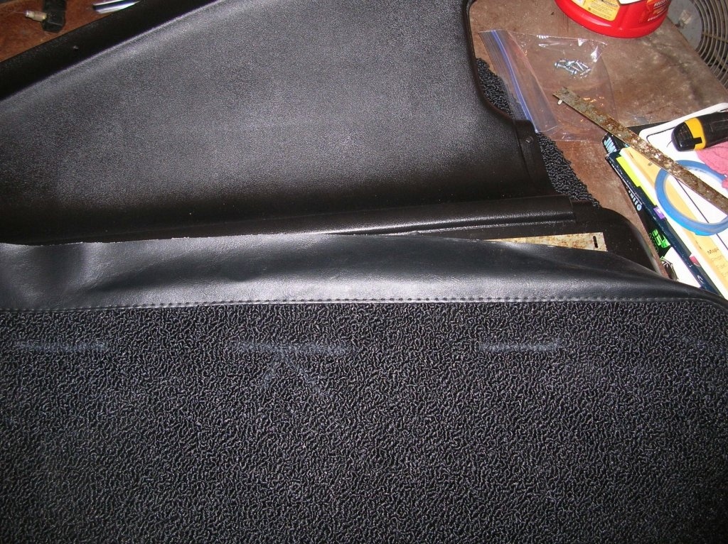

struck out on finding any chrome trim, but I did find two straight strap type pieces with notches and punch outs that line up with the holes in the trim panel....so it is now more confusing. Does the vinyl attached to the carpet get wrapped around the metal strap and than attached to the panel followed by gluing the remainder of the carpet to the panel.....stressful...lol

Those straps look familiar to me. I'll look tomorrow for my "straps"
The chrome not so much.
I used this on mine.
no chrome trim on any car, it's those metal straps that hold the carpet to the panel....carpet is folded over the metal and then attached to panel
OK....it is the vinyl portion attached to the carpet that wraps around the strap and than mounts to the panel, followed by gluing the carpet to the panel?
Carl
It's flat metal with spikes in it just like the bottom of the front seats carl. There is chrome on the center console that the carpet goes under FYI
