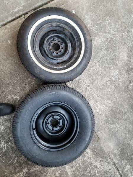

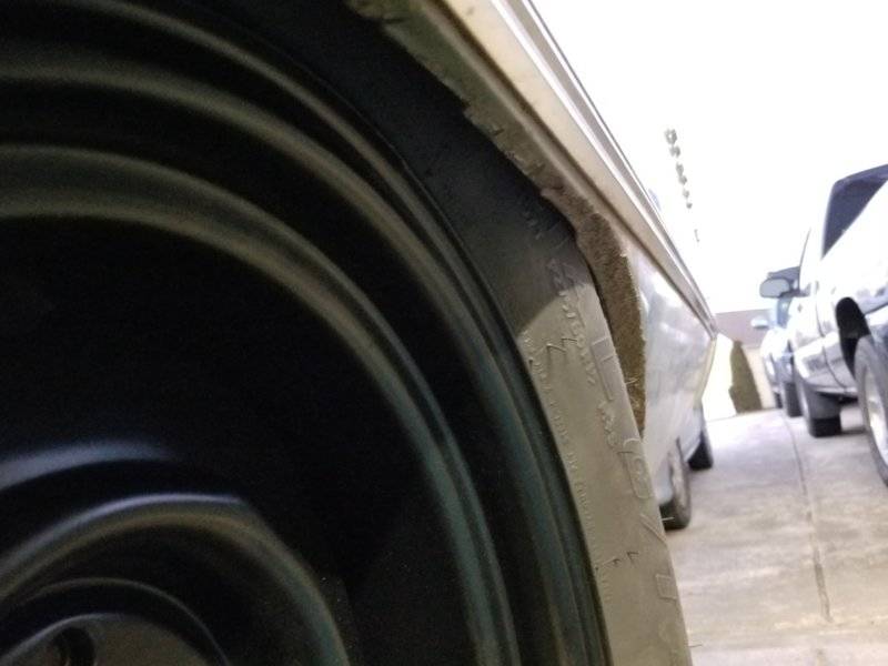

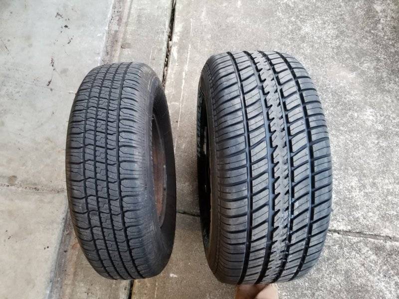

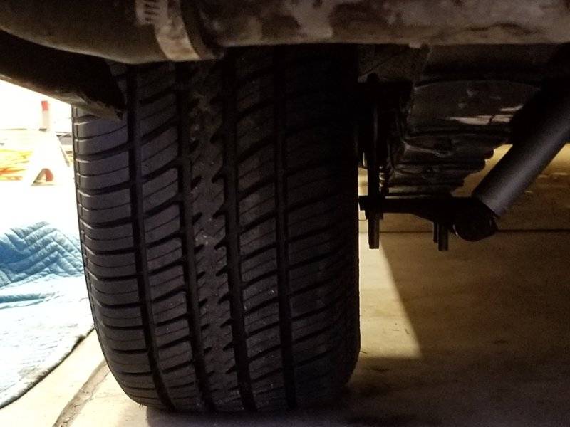

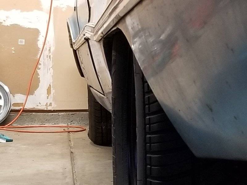

Welp, I knew going bigger was going to be a risk. Cooper Cobra 275/60/15 and Wheel Vintiques 15x8 4.5bs officially do NOT fit a 67 Coronet without modifications. I was able to get them on there by moving the rear end up and down but they pinch on the wheel flare where it bows out slightly. I'll probably trim that as I think it would look better without it. I'm a little concerned the wheels stand off from the drums more than the stock steelies. Probably enough to make the pinching difference. Not sure what I'm going to do yet. Try 255/70, mod the wells, or look at grinding the back face of the wheels down some.

Well crap, sorry they didn't fit but thanks for posting the pics.
Sure thing. I think I'll be making them work. I've read about several who trim that whole part of the well lip back to the trim piece. This makes sense to me. I'll take a closer look tomorrow and document. I'm definitely guessing the upper part of the inner well will need some love too.
Not trying to tell you how to do it, But........... I would clip that lip straight back to the body every 4 inchs and just fold/dolly it flat to the inside. I will help keep that edge stiff.

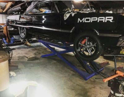

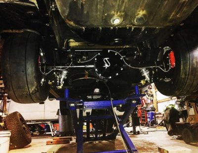

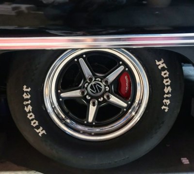

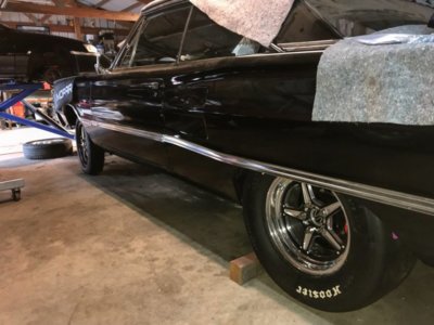

Crap wish I would’ve seen this, I had 15x8 with 5.5 backspace and a 28x10.5 tire and it would only rub on hard turns. Currently have 15x7 with 4.5 with 275/60/15 and it clears with about an inch or so left over.

Nice ride! I think there's still some variability between cars. And probably these wheels. I wanted steelies, but also didn't want to wait for custom width/backspacing. Couldn't easily find Ramcharger steels. I think I'll be folding up the lip with a heat gun and rubber mallet. Not like I have paint to ruin. I'm still thinking the inner well won't fit either though
Yep, agreed. Will trim, heat it, and fold carefully and seal it with some rtv or something. I dabbled in blacksmithing, so I'm no stranger to moving metal

Was able to stuff 255/70 Cooper Cobras under on the Wheel Vintiques. I have two Draglites 15x8 5.5bs on order though. That will get them centered in the wheel well. Guess I'll have the Wheel Vintiques for sale, haven't gone a mile on em

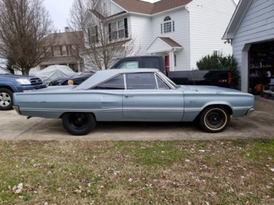

Thanks for not cutting or rolling those nice quarter panels!
I was going to say I've had 225 15 on factory 15x7 with no problem (unless you call the juggle to get them in a "problem") and I'm pretty sure 235 would fit.
I'm confident the 255 will be fine once the draglites move the wheel closer in to the springs. The back half of the well is almost perfectly above the outside edge of the leafs on both sides. On driver side I had about 1.5" of space to the leaf and about 1.25" on passenger. With an extra inch of backspace, they'll actually be further in than out, so I may actually center them with spacers. Better to have too much spacing than not enough though. But I think there's enough well for a 255. 275 I don't think so.
