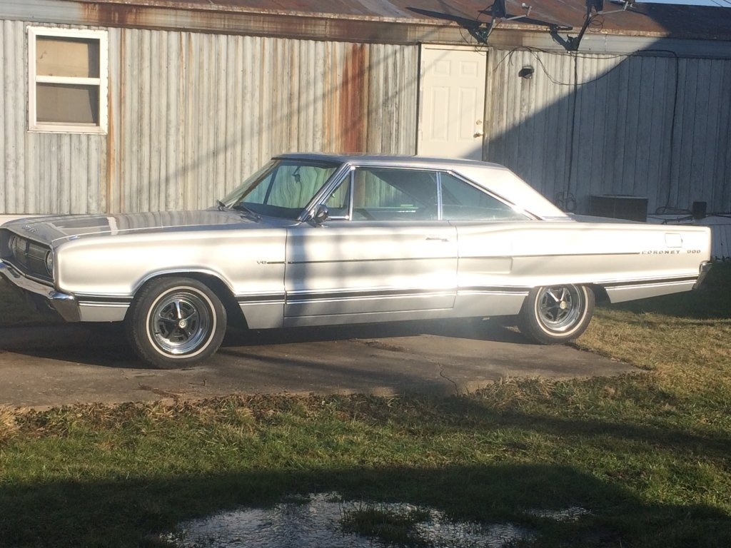

I'm throwing around the idea of getting either side exit exhaust or running it out the back.I put on headers and have been running with just them after having them ceramic coated. I also bought the 24" Dynomax bullets after hearing them on a friends duster with a 318. I'm not too sure yet, but a picture of a 66 Charger has me wanting side exit again. I wanted to hear pros and cons of either and recommdations. This site has many knowledgeable people that have probably done this at one point or another. I also ordered an air gap to couple with a holley 4160 600cfm carb I rebuilt and wanted to know if a 600 would be too much carb on my 318. I know there is a port mismatch with the heads but I'm saving for Indy LA-X heads from IMM. Which later I can swap over to a 408 that I'm slowly gathering parts for. Thanks in advanced for your feedback!
Your car should have exhaust past the rear axle[behind rear wheels or at the bumper] It looks stock[nice], and that other look is kinda cheap looking. 2-cents. It also gets annoying, listening to exhaust after awhile. Again, 2-cents

Nice Coronet too. Congrats.
