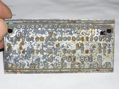

OK - So I have a 1967 Coronet 500 R/T convertible project car in my barn. It has a fender tag which I have never bothered to decode, but does have a 383 and 727? Sounds like I need to decode that tag as you all have peaked my interest. I am pretty certain the 500 and R/T emblems are real and original - any feedback would be appreciated.
Pretty easy to tell and you don't need the tag info. Look at the VIN.
WP = Coronet 500. WS = Coronet R/T.
Coronet R/T = 440 (WS27L) or Hemi (WS27J)
Coronet 500 = 318 (WP27F), 383-2 (WP27G) or 383-4 (WP27H)

Here is a picture of the tag, can any of you tell just what this is saying?
Still a nice piece- 500 vert with 383-4!! :)
