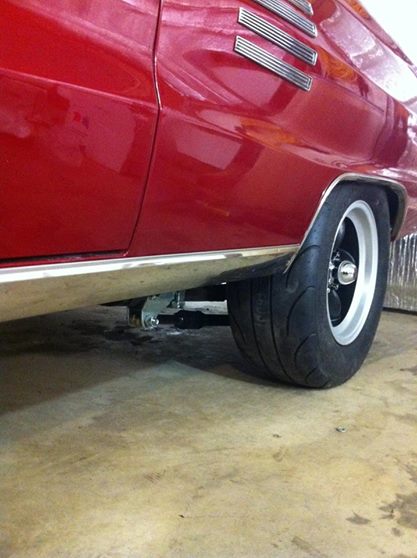

p255/60R15 with 4.5" backspacing... fills the wheel well up fairly well. I would recommend rolling the inner fender lip if you wanna try 275's. It would be tight
Thanks for the response and the pic. The 255/60's are where I was originally going and probably the safer bet.

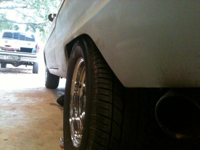

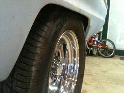

255/60's on 8's here too, they still rub every now and again...
