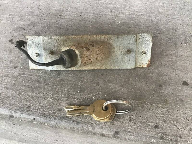

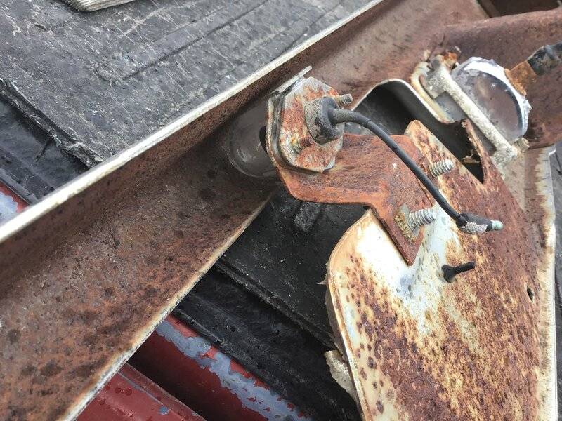

All 66-7 Plymouth b bodies will be the same, and also Dodge I think.
Dodge Coronet is totally different. See photo, Plymouth is flat and rectangle shaped, and it mounts in a different place.
CFA4ADF9-FA0E-49FC-A13C-38C9E71B2355.jpeg 5000EF8F-A781-44DF-932A-51D1C3E85D37.jpeg

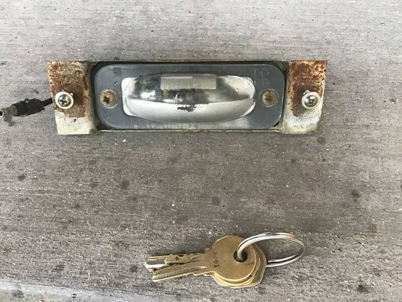

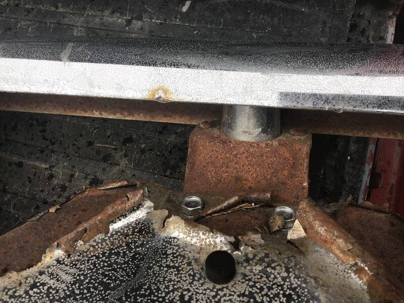

This is a 66-67 Belvedere license light. Goes above the plate, two tabs on the bumper with holes, screws thread into the light housing.
E2C50E8F-12F1-4760-A0A0-1628AE867DBC.jpeg E7AFA09C-0C83-4314-A4EA-07AC87F6D08A.jpeg
They fit many chrycos from 64-74.
