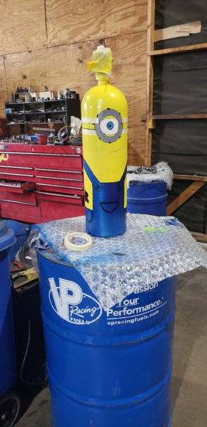

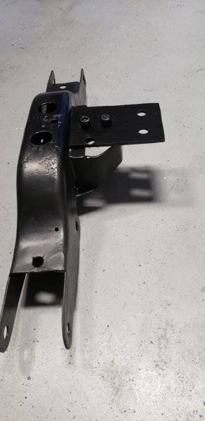

67 Plymouth spring and mini tub mod

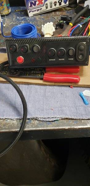

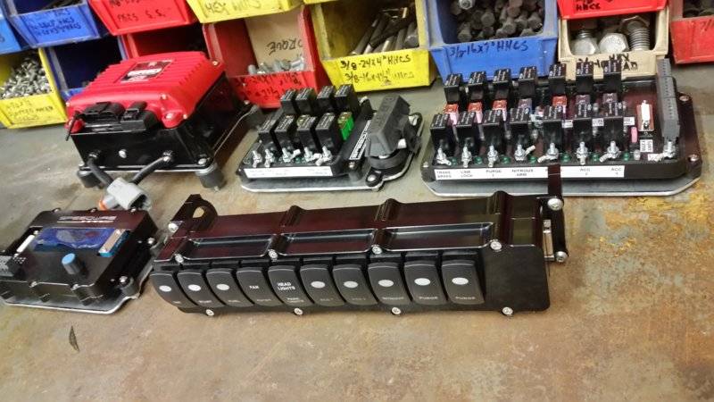

Switch panel for n20, brake, gear vendors,
ect

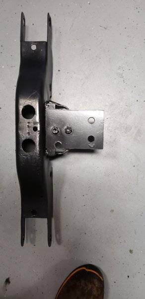

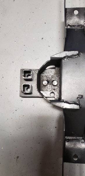

Modify for powerglide. 2 bolts, flat peice of steel. 2 1" square stock and dupli color's best black paint.

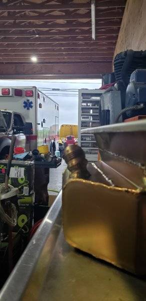

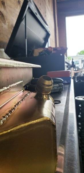

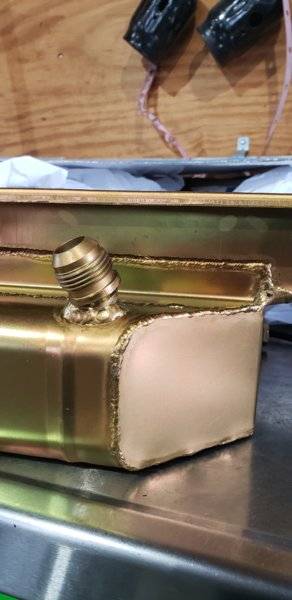

Thoughts on this pan? Isn't the fitting supposed to be straight up? Maybe they angled it for clearance reasons? Looks solid though.

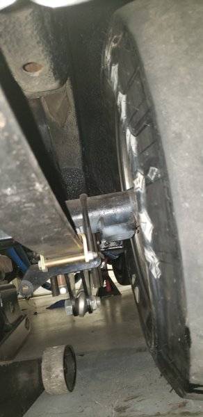

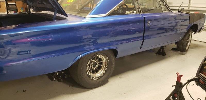

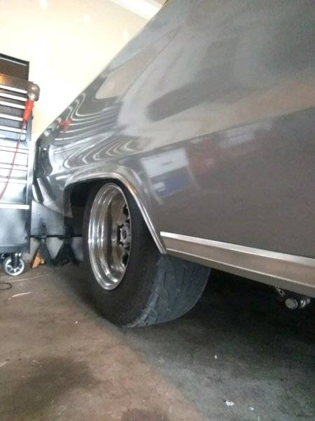

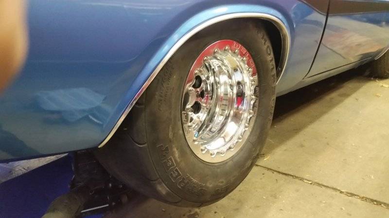

Buddy let me try these on for size. 15x10.
6.5bs
28x10.5 tire.
Plenty of room.

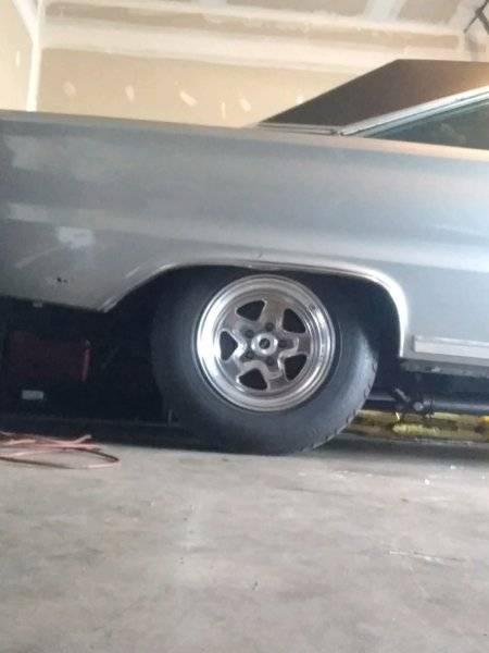

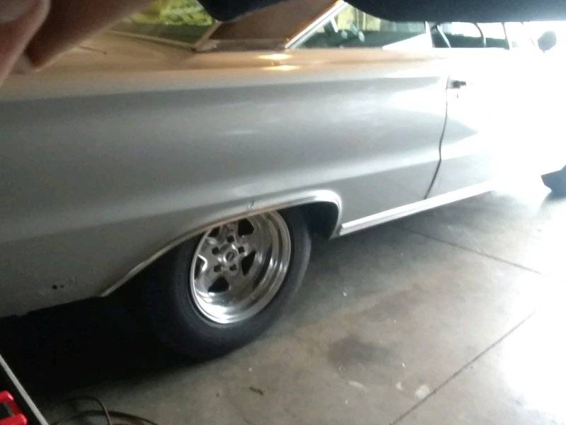

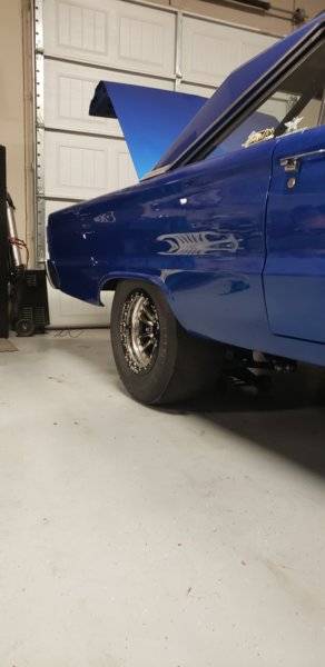

Here's mine with just a 28/10.0 tire I think that 10.5 on your car gives it a better look
I enjoy seeing your progress keep up the good work

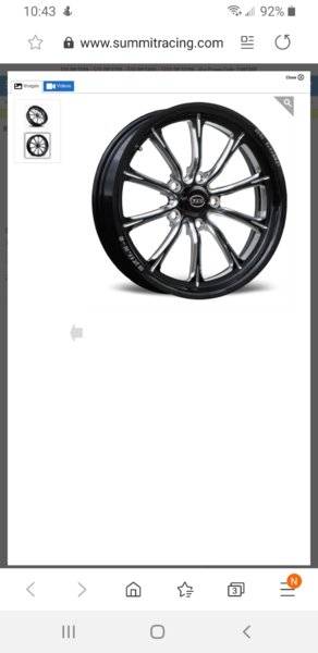

For some reason the 28 on mine looks like it fills the opening more. I ordered rc eclipse wheels yesterday.
I believe that because yours is a 10.5 tire and mine is a 10.0 tire yours fill out more I'm also have a 15x10 inch wheel with 5.5 bs to sit center in the wheel well

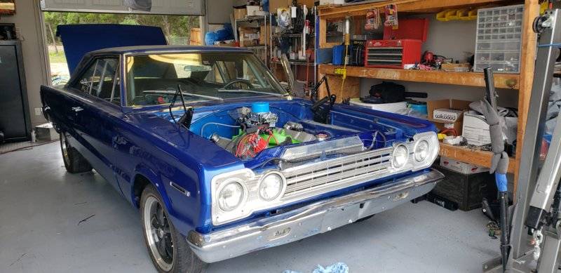

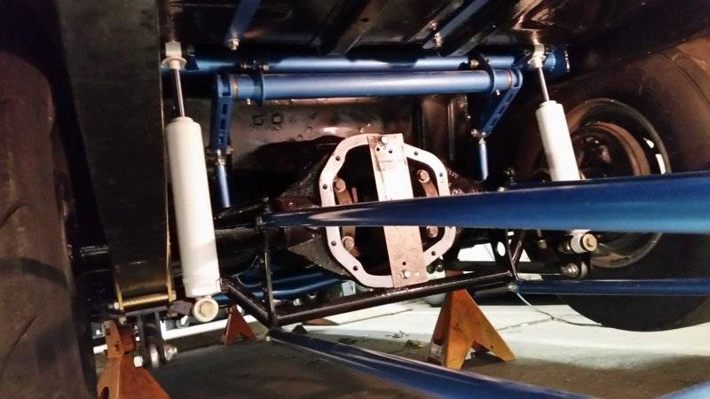

Almost ready, need to set pinion angle, exhaust fab, some nos wiring, hood and whatever else.
