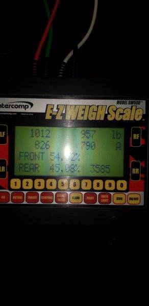

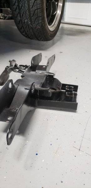

Had to reinforce trans mount, it sagged a little bit when the weight was on it

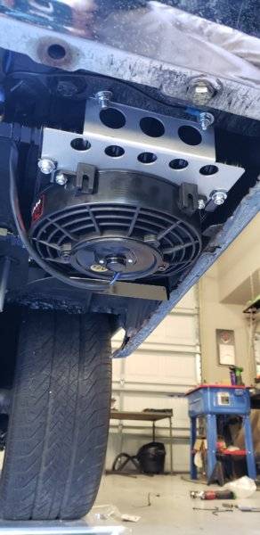

Trans cooler in place, needed a little weight in the r/r. Had to fab up a shield so rubber wouldn't clog it up.

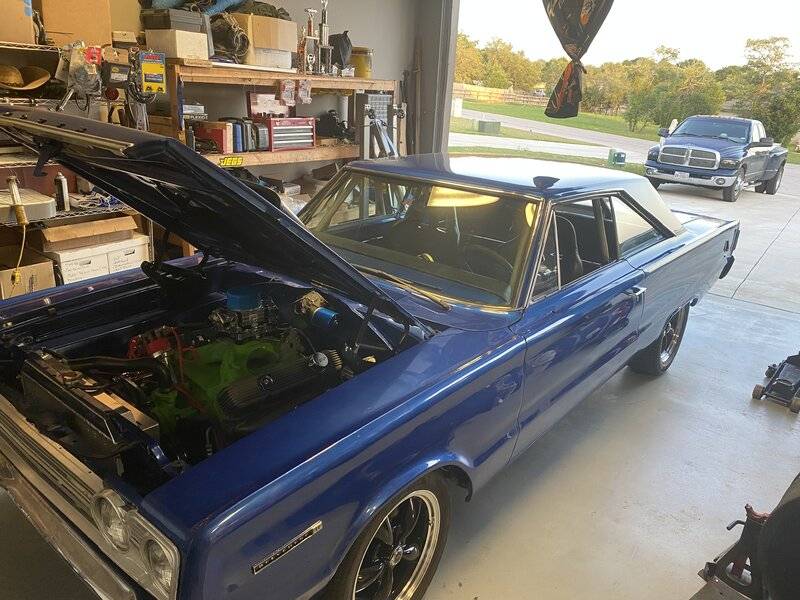

Drove her around the block yesterday,it’s been over a year since the last time. It was Great! Didn’t test the go over drive because you have to go at least a mile before turning it on. Pr instructions. I ended up with 4.5deg for a pinion angle. No noticeable vibes yet, did not gas on it or anything like that. Have to finish wiring max 5 n20 controller and a few other things. And pass seat.

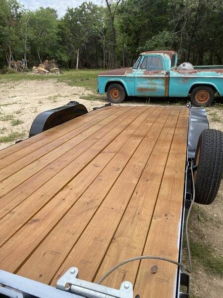

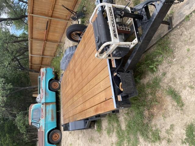

Replaced the deck on my trailer and sealed. A little more paint and it will be ready

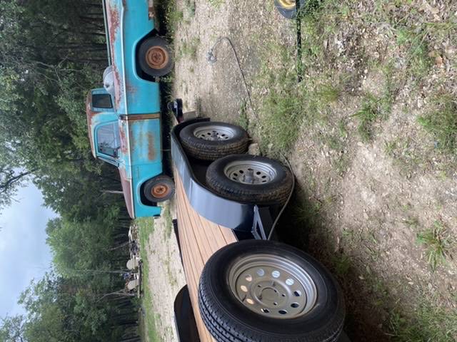

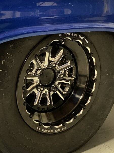

New wheels for the back, ordered the wrong size for the front so it will be a couple of weeks
What did you use to replace the deck, was it treated lumber? I am getting ready to redo mine as well.
Used treated 2x8 from local lumber yard . Half the price of home depot and Lowe’s . Let sit for a few days and applied fence and deck sealer.
I used new lumber. I read the post it looked like I said I used old used lumber

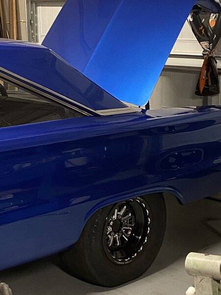

Planning on doing some tnt at out local track on Friday. Plan is to go straight and check plugs. Will worry about times when all is good.
