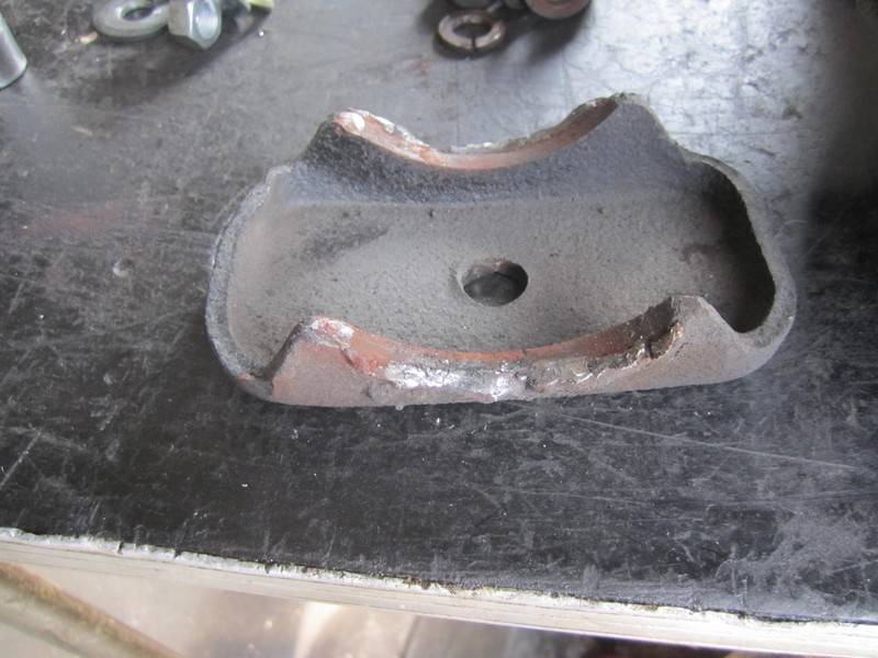

67 Plymouth spring and mini tub mod

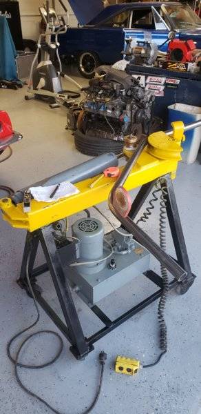

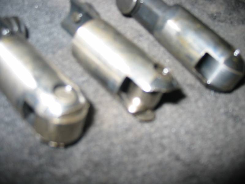

How much seat pressure? All of it and then some. Are those isky rollers? I have red zone by isky

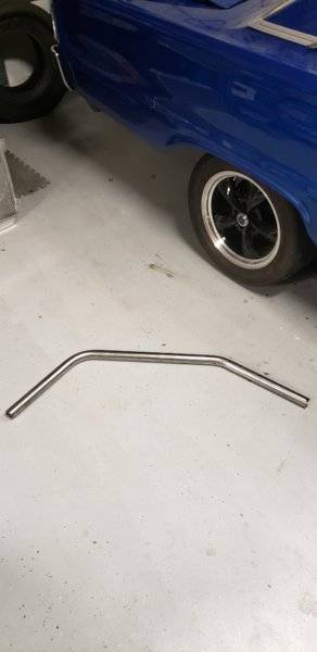

Not as easy as it looks
Yep harder than it looks. First thought is build one out of pvc pipe to get the angles then bend your pipe to fit.
Sure like the press was it big on the wallet.
The press is a buddy of mine who hasn't used it in4 years because it had a leaking cylinder so I sent the cylinder to a hydraulic shop and cleaned up the rest. Painted to factory colors. I figure he will let me use it anytime now

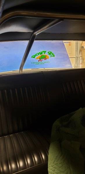

Does that bar go from the A pillar bar down to the frame?
Mine run from mane hoop to the frame rails in the trunk. Not the shock tower bar. But on the pro street hoops I have seen them at the shock tower and to the frame rails in the trunk. I'm sure someone that has the pro street bar will chime in.
I'm running mine right beside the minitub on top of the frame with the 6x6 plate
Okay cool you are using a back seat with mine I'm not. I'm curious if with the plate how does it work in the space that you have. Does the shock tower bar get in the way of the bottom plate.
Next question the side bars do they hit your front seats.
No, I'm welding the 6x6 on top of the frame rail directly under the package tray. Not sure on the seat, but pre mock up the door bar hitting the door handle.
Main cross bar at shoulder height side bar at the middle of the upper arm should miss door handle.
