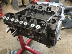

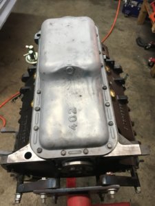

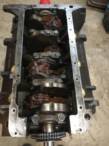

I might be doing some things out of order but have a car blown into all its parts is over whelming to say the least. Since the engine was back from the machine shop already I decided to get that put together and get some parts off the workbench. Everything went back together pretty well without a lot of drama. I have one freeze plug that is oversized for some reason. I remeber wresting one out when I tore the engine down. Sure enough it was that plug. I saved all the old plugs and I can tell that one is different for sure. I guess it was this was from day one.

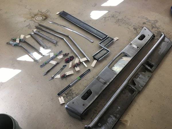

I have all my chrome gathered up and I'm going to LiBrandi and Paul's Chrome this week to get prices. More on that later.

I was referred to Pauls chrome as well by a good buddy. They did amazing work on his car. I have some of the same exact parts you have I need to send (fellow 67 R/T owner). PM me when you get pricing. I would love to know about what I would be looking at for costs.
I'll let you know what I get regarding quotes. Both shops will produce about the same product and both are within driving distance so I'll save shipping cost. When I bought this car I had no idea what to budget for chrome. I'm anxious to get prices, I'm either going to be shocked or pleasantly surprised.
Thanks and I feel you. I don't have a clue on chrome pricing. I am as interested as you to find out. I would have to ship, so having an idea before that would be great. Let's hope we are both pleasantly surprised!
That makes three of us, I need the rear finish panel and the taillight covers done. I could likely drive mine to PA.
I use Paul's Chrome and they do stellar work.....As far as prices go for my GTX...a single bumper in good shape will be around a grand for a plymouth(large bumpers btw), my tail lights bezels(almost zero pitting)I think were around 900 and the tail panel(NOS and very little pitting) was around 1100 for example....

I'll get into more detail about the chrome experience this weekend. It was eye opening for sure.
Prices between the two shops were not even close. The 67 tail panels must take a looooong time to replate. The one quoted above is less than half of the 67 price. Rest of the prices are spot on.
These parts are in relatively good shape as well, I would say these prices are the starting point.
The tail panel is in good shape with little pitting and the price was $2500 @ Paul's. Just for the center part. Budget blown for sure. The cost to restore these cars vs what they're their worth when done is staggering.

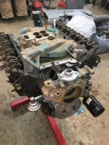

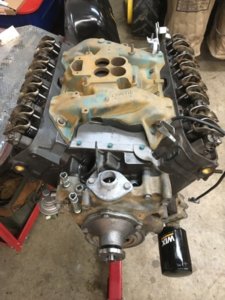

Worked on engine assembly today, got most of it buttoned up. Lots of glass beading and cleaning. Cast metal gets a a rust haze on it almost instantaneously after washed off.
So far the plug wire brackets are salvageable. They are the original ones.

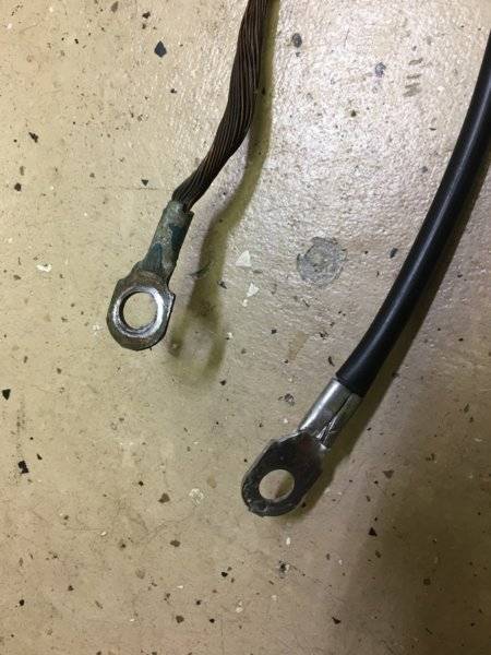

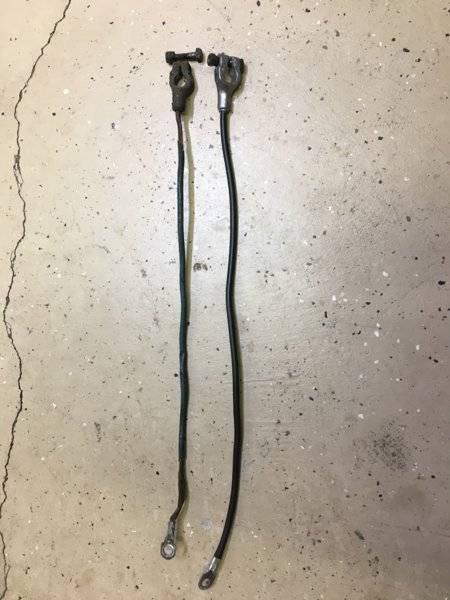

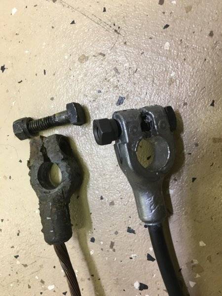

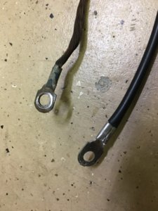

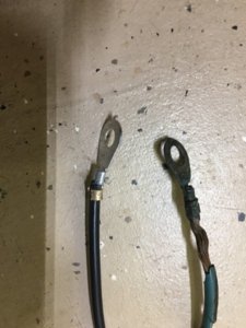

I ordered a negative battery cable along with a firewall ground strap and they came in today. Items came from Herbs and they did a fine job, I also got some of their custom mix vinyl dye. I'll post more on that when I use it.

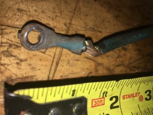

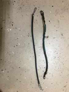

These cables are the 'correct', very expensive, ones. Both the cables on the car were original. Couple observations:
- New cable lengths are wrong. Whoever is cutting the cables is measuring the wire and. Not end to end.
- New cables a pretty dead on regarding cable ends. Crimp is different on the battery cable and head markings on the bolts are slightly different.
- Both my original cables had a lot of engine paint on them out at the ends. I suprised how far the paint went out on the cables.
Some things we buy seem like a great deal. I can't say that with these cables. Seems to be no competition in good, accurate, repop cables. At over $100 I think there was plenty of margin. These came from Herbs and I assume they are M&H.
Pics show the differences.

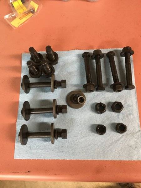

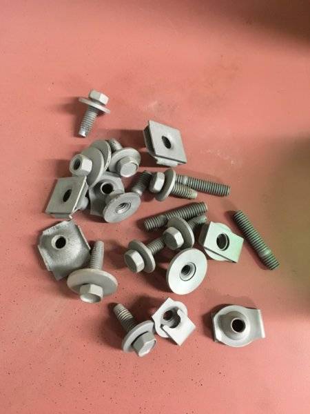

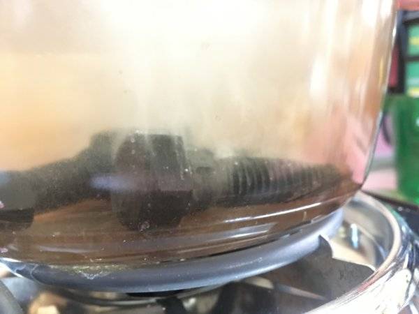

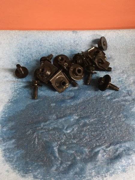

One of the things I learned about while resorting Chevys is how to phosphate. It's very simple, basically if you can boil water you can phosphate. Most items on the car like hardware has a phosphate coating. I found a company online that sells supplies called Palmetto Enterprises, he sells zinc and manganese phospate concentrate. Cost are around $25/pint and they cut at 14oz to a gallon of water, little more solution needed for zinc than manganese.
I spent all day doing this, time is the prep like anything else. The glass bead cabinet was running hard today.
Supplies:
Hot plate - $10 @ Walmart
Tongs - $3
WD-40
Candy thermometer - $5
Vessel - glass, porcelain, or stainless. I found an old glass pot from the '80s.
Measuring cup
Phosphate concentrate
Instructions:
1. Bead blast items to be put in solution. Instructions say only allow 2-3 hrs between beading and coating. Metal needs to be fresh for chemical bond.
2. Start with water and get that to almost 190* then add phosphate concentrate.
3. Maintain vessel temp at 190*-200*
4. Add parts. When fizzing stops give it a few more minutes. It seems like 5 minutes is the time in the bath.
5. Remove parts and soak with WD-40. Wipe parts and repeat again.
That's it! You can do this in your house, there is no odor. I like the setup in the garage so I can have an assembly line going. End result is brand new looking hardware that was born with the car. No need to buy all new hardware if your willing to take the time.
Most everything is supposed to be zinc phosphate, that color is a lighter gray to the brown side. Manganese is a darker finish but it's really close. I used manganese since I had that left over. If you pull parts sooner rather than later they will be lighter colored.
Started with fender hardware, these were Evaporust'd first to see what finishes were on them.
K Frame bolt
Here you can see some new AMK fastners on the left.
Here's some front end and trans crossmember bolts.
