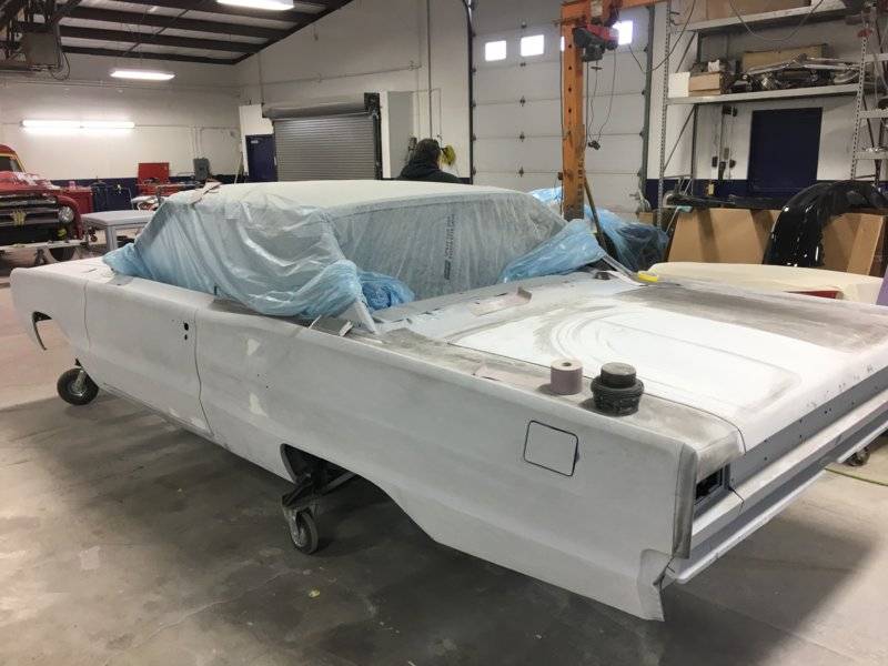

I stopped by the body shop today and checked on our progress. Week 2.
Car was shot with primer surfacer and 220 blocking right now. First round of blocking is 75% done.

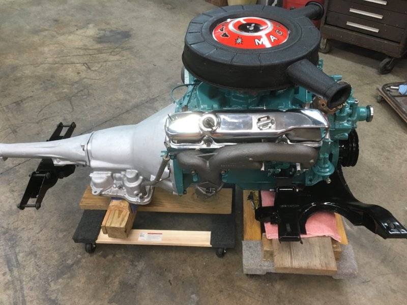

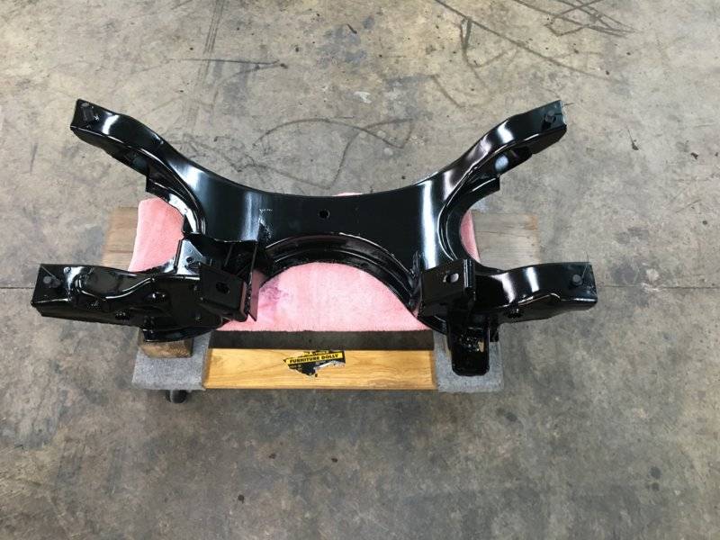

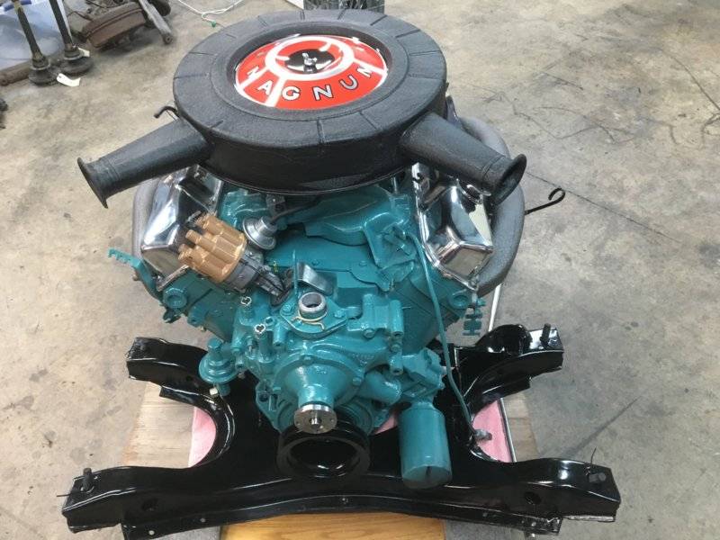

Lots of fun stuff today. It's time to start getting part put together and build out the front subframe. Engine and trans are back together again.

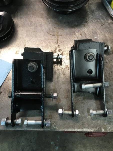

Engine mounts are service replacements. Bolts were all replaced, cross memeber was bead blasted and painted. Trans mount itself is the original, dated 33rd week 66.

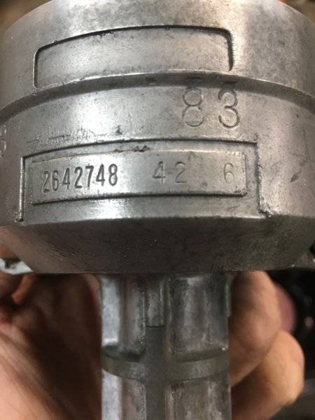

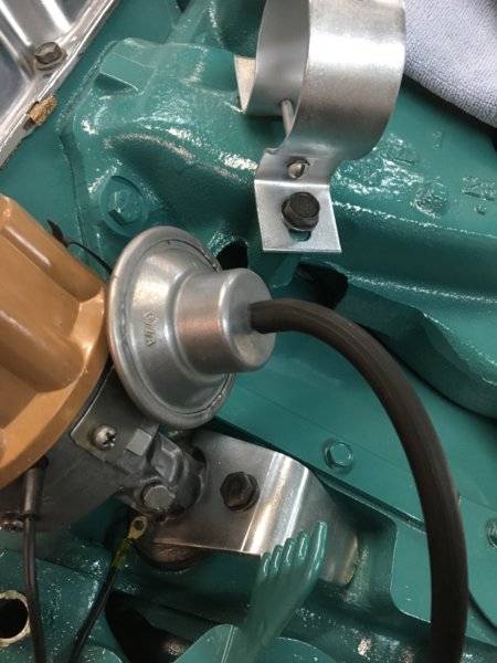

Distributor is the same, all original including the vacuum can. Date code is 42 6.
Coil bracket and distributor hold down are original. Bead blasted and new clear zinc.

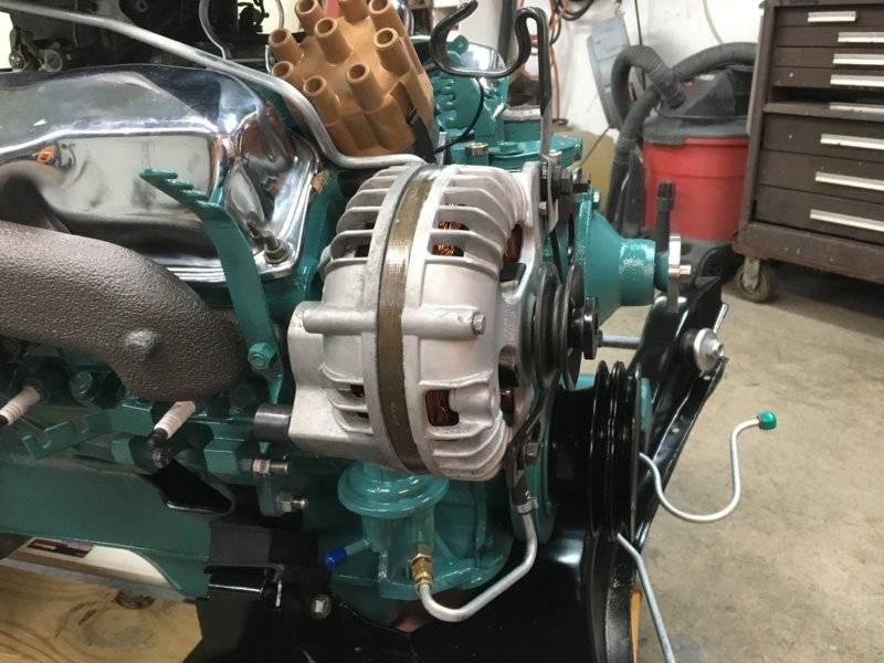

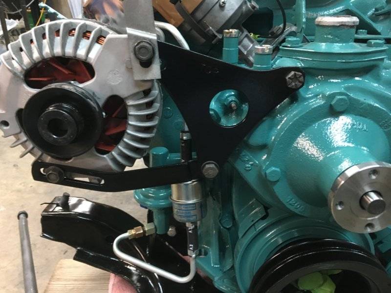

Had a couple hours to work again on the car today. I installed the alternator with all the brackets The hose stand for heater hoses is original to the car, it cleaned up very well. Date code on the alternator is 34 6. Again, the starter and alternator were rebuilt by a local company that does not specialize in restoration work. Both starter and alternator were cleaned up and rebuilt, my bill was just over $100.
Next was the trans cooler lines, these are from Inline Tube. Matched the originals well. Original clip below the starter.

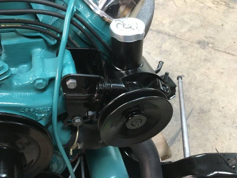

Had a couple minutes to work on this today. PS pump is resealed and installed. I used the hardware that was on the car, I have no reason to believe it was replaced. Top bolt is clear zinc with no washer and lower is phosphate with washer. The pump with installed bracket and pulley were all painted together from what I can tell.
Also note the heater hose clip is galvanized, last repop I bought was aluminum.

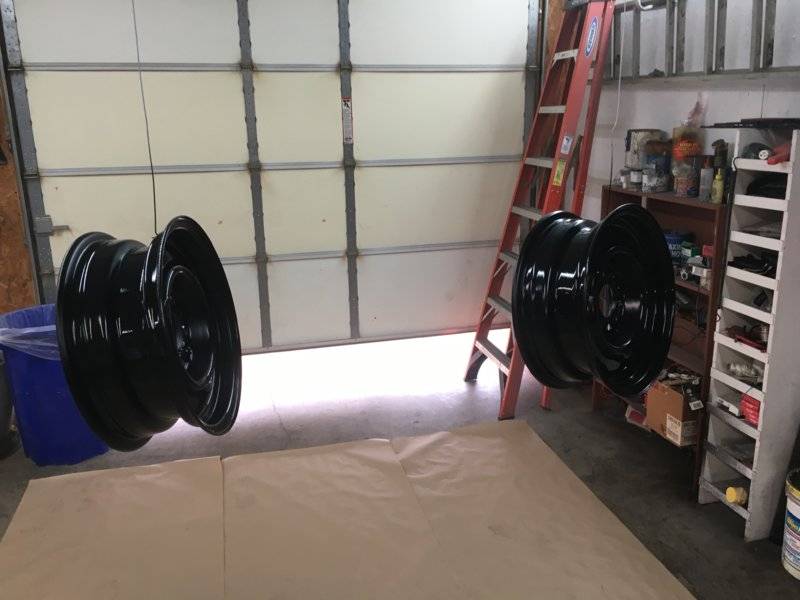

I also painted 5 steel wheels and rear end housing. PPG epoxy primer and JE enamel as top coat. These were all media blasted.
