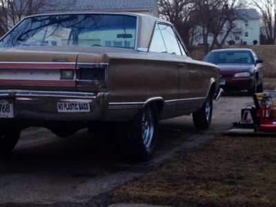

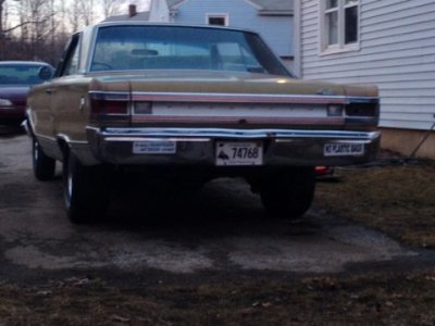

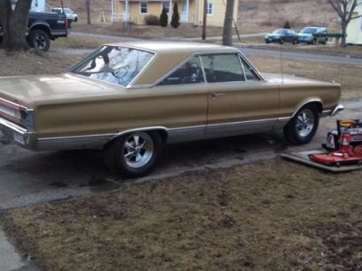

IMG_1129.jpgIMG_1133.jpgIMG_1131.jpgSame car here, I had swapped in my 440 with the stock T bars and leaf springs. My stuff was also whipped. Car was mushy, but the front end is good for drag racing. If you're not interested in maximum weight transfer, and since you don't have 500+ horse anyway, go ahead and run the GTX T bars (.92) and the XHD leaf springs. The stock springs in these are the same as the Road Runners and whatnot with standard suspension. Mine, being very worn out, would hop a little bit, I had 2.94 open gears.
I've now got Super Stock springs, new shocks, still need to rebuild the front end, and the engine makes ALOT more power. Haven't had her out yet, I've got a set of 383 torsion bars I want to swap in to get the stance I want without having the T bars wound up all the way.
