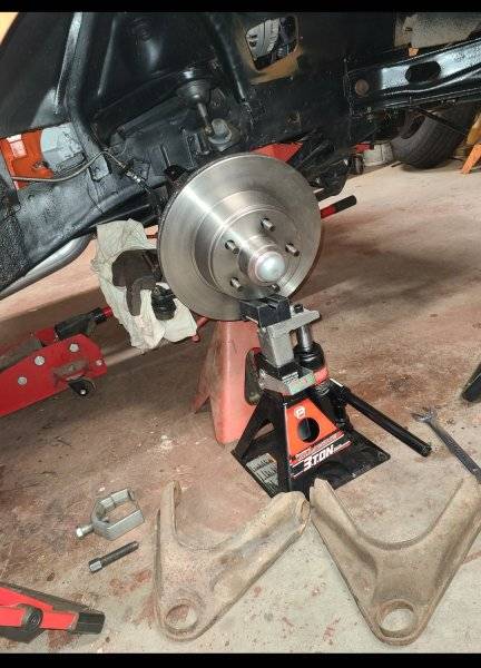

Yes I have aligned my Satellite. Manual steering car. I have played with the caster and camber quite a bit. Stock suspension I started by adjusting the right side caster as high as possible, I think it was 3.75 caster and -1/4 camber. I adjusted the left side to match less 1/4 degree caster. The car drove great and straight. I liked everything about it except the parking lot maneuvering. After several hours and several test drives repeated. I found that right side 3 caster 0 camber. Left side 2.75 caster 0 camber. My car drives great, parking lot maneuvering is ok
Caster Has a great influence on cornering and straight line stability. Castor trail or mechanical trail helps with bringing the wheel back to center.
I believe that our cars can drive ok using that chart, but cars are individuals just like us.. Play with the numbers and road test to see what fit your car and driving style.
Also with our B bodies having torsion bars, make sure you set the ride height to where you want it before you have it aligned.
Remember there are other angles in play that need to be checked during a proper alignment
S.I.A. And included angle are diagnostic angles.
