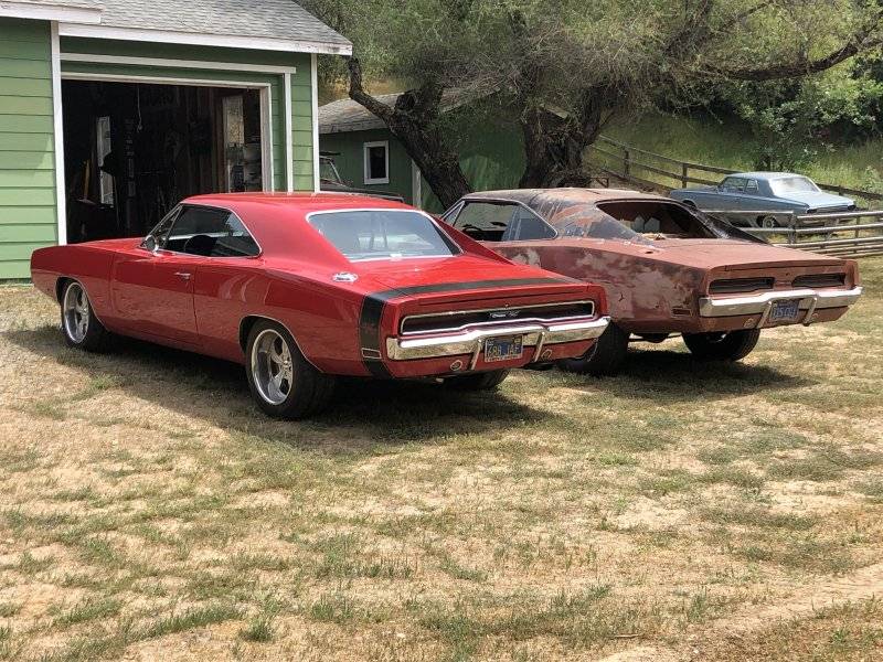

Sorry, man....you are confused. NEW cars come with a LOT of caster and they are far more stable than our old stuff when aligned to original specs.
I run 8 degrees of caster and a full degree of negative camber in the red car and 6 degrees of caster and 3/4 degree of negative camber in the other one.
No, the cars don't follow ruts, they aren't blown around by the wind or any other such nonsense. They track straight and the tires don't wear irregularly. Your words seem like those from a factory engineer that knows theories but has never actually deviated from stock to know what really happens. Even Rick Ehrenberg, a man that is also a strong proponent of following most OEM guidelines, advised for alignment settings far different than stock:
