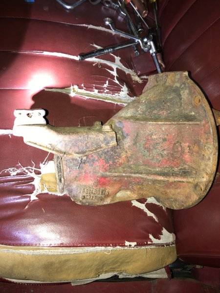

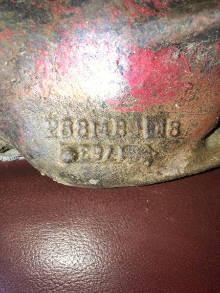

I just remembered I took the original one out and was just using this as a roller. I think the original one is a 8 3/4 maybe...
check here to see what they asked for a dana 60 rear in the for sale forums
9CA55828-DD8D-4699-9B6D-72DE5D8D6B88.jpeg E3371B11-3912-4A87-B3BB-7D7637DCE35E.jpeg
it is a 489 8 3/4,whats the roller diff out of
