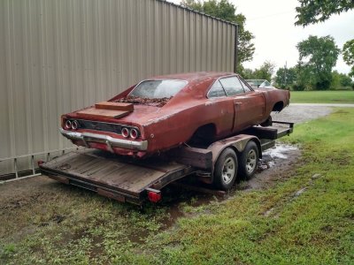

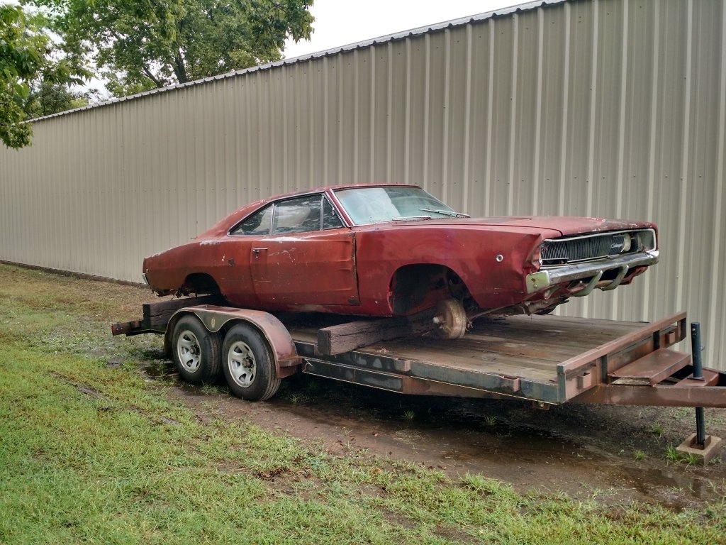

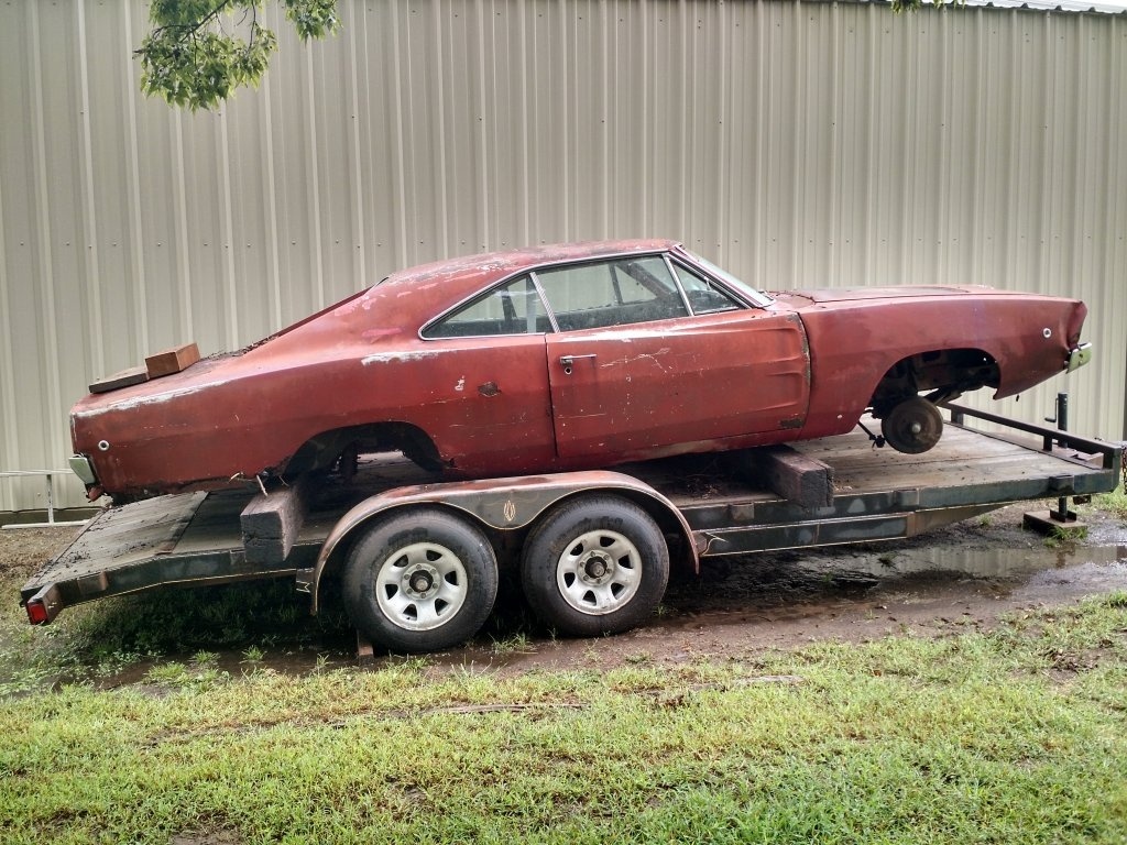

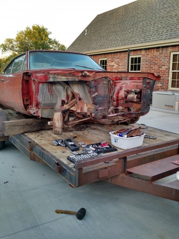

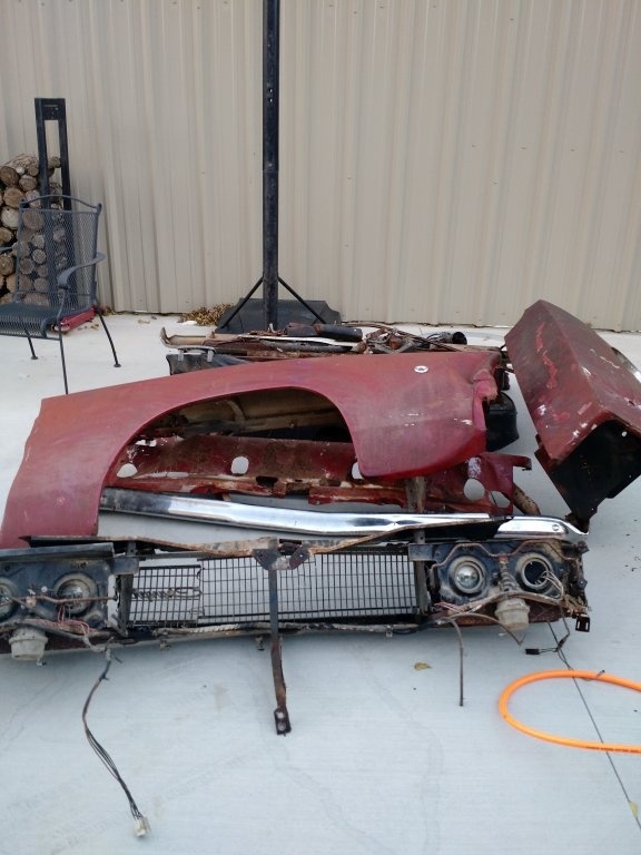

I am new to "forbbodiesonly". I recently acquired a 68 Charger 440 R/T from my neighbor that had it sitting under a tree for almost 20 years. Needless to say it's going to be a MAJOR project. Here are a few pictures to get started.

This is my vision for what I call a mild Resto-Mod.
Great project. 68 is my favorite. Welcome. More specs on the car? Does it have the drive train?
Welcome!, Of course 68 is my favorite also. They have the best looking rear end. I am excited to see this thread. You have a good start. Keep up the good work.:thumbsup:
