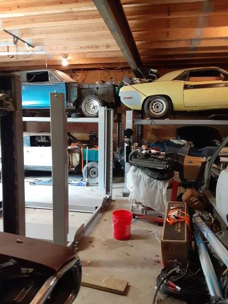

I already have several of them! It's not my fault the Charger market is insane.
I spell it whored!actually it is...... if you flood the market with some of that hoard, it might correct a little![]()
