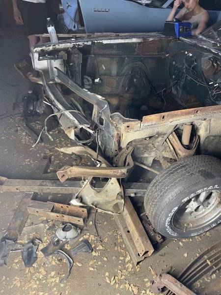

Been a minute since I last did anything with my Charger. A buddy and me just started pulling and tearing apart the damaged side of the car. The frame rail is surprisingly straight still, the frame horn and bumper bracket took the beating. The inner fender, core support, firewall, and cowl are still bent and buckled. I think if I got this on a frame rack the whole side of the car could get pulled back into shape.
Hopefully you can reuse what's there after hitting the rack. If not, at least the pulls will help get the surrounding areas back in shape so you can replace with other.
I had to do a similar fix on my RR, only not as extreme. The frame rail was pushed upward an inch and back 3/4". You would be surprised how easy it will bend once firmly bolted into a fixture. Getting it pulled back out far enough longitudinally will be the chore but not impossible you will probably have to straighten/replace the firewall and cowling first. Looks like a fun project!

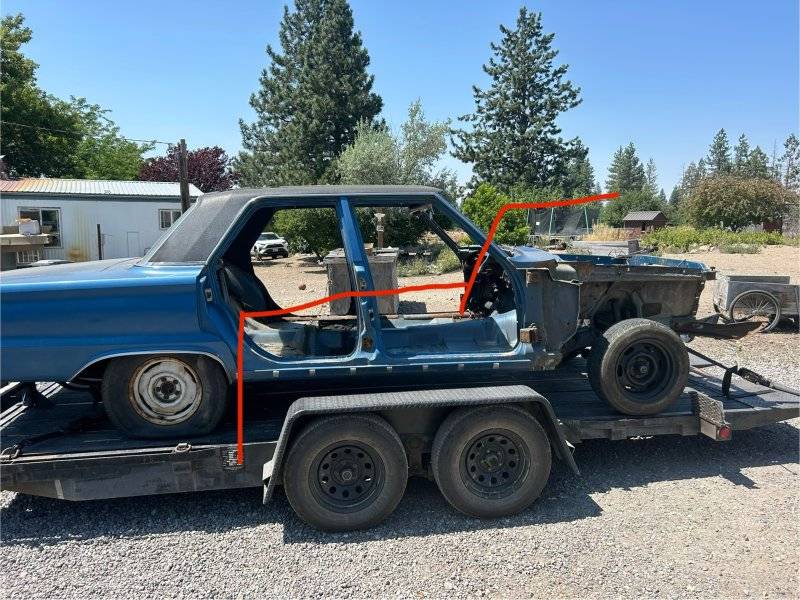

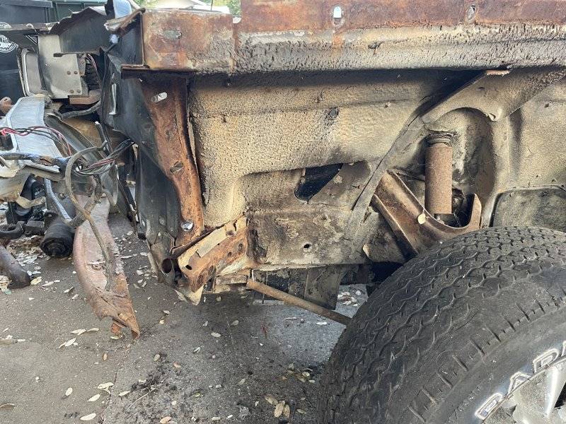

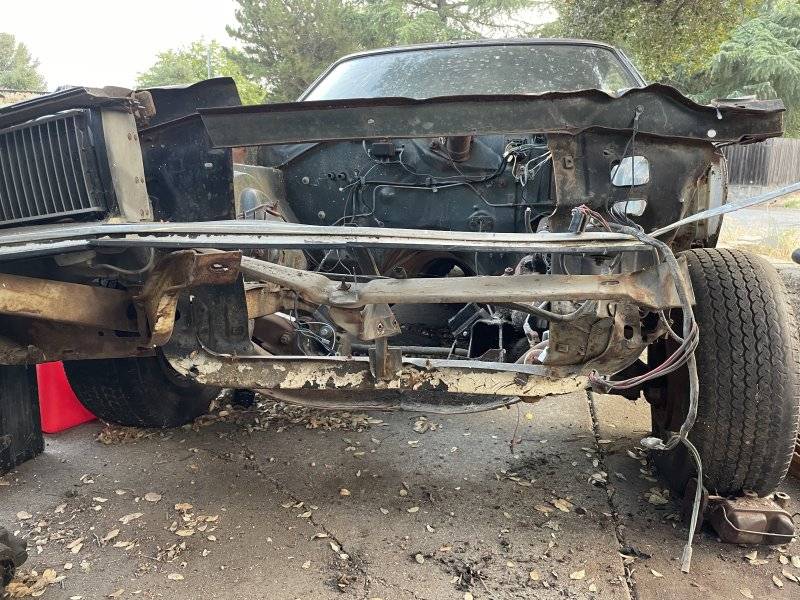

Got a few more pieces pulled off of the car to better expose the damage. You can see the bent frame rail, buckled inner fender, and scrunched cowl. I recently found this 67 Belvedere shell that was parted out, I have a scheme to take the floor pan and everything forward and swap it into the charger as one piece. My floor pans are shot and this would save me tons of time and money, and lets me use original metal instead of modern repop stuff.
You could have the worlds first Belvacharger I suppose-
That's the best and quickest method IMO. You get that swapped and the project well be very well along. Charger backends are a nightmare to stitch together but they all need it anyway it seems, even the ones that look way better to start with.
