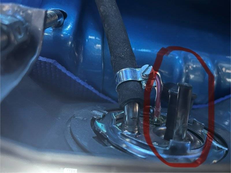

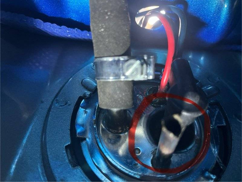

After the fuel filler tube and new fuel tank got installed, I noticed there’s a nipple near the top of the filler tube, and another, on the fuel tank next to the actual fuel line…see pics.

What you have circled there on the sending unit is for the fuel return line. Not sure on other years but 68-70 440 and Hemi cars all had a vapor separator mounted to one of the fuel pump bolts with a 1/4” return line back to the tank through the sending unit. As for the vent line on the fuel filler, yes, you can just make your own out of a brake line. It does in fact just run down the fuel filler and goes through the trunk floor into the top of the drivers side frame rail. Dead ends in there just open, nothing on the end. There is a rubber grommet where it passes through the trunk floor.
Also you might want to get a grommet installed where your wires run through to your sending unit. Good spot for a short to ground if it rubs through the insulation :thumbsup:

Ok, since there is no mechanical fuel pump (now electric-in tank), and no vapor separator, do i just cap off that 1/4” nipple located on the tank sender unit? Or should i connect the vent line from the top of the fuel filler tube down to this nipple?

Yes, you will want to cap off the return line port on the sending unit. Rubber hose will work for the vent line. Metal line will look nicer and more correct in my opinion, but it’s your car so go with rubber if you want.

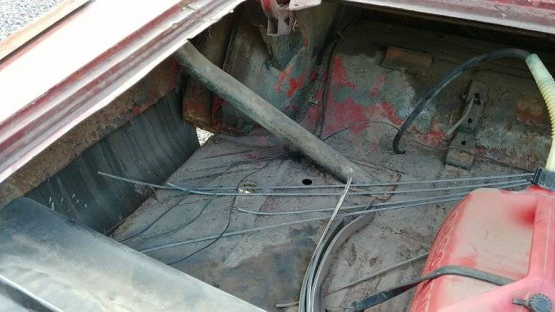

I looked around till I found a picture on line

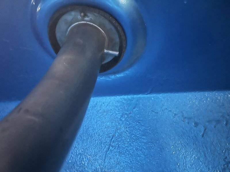

There should be 2 holes in the floor beside the opening for the filler tube but they only come with one
The second hole should be drilled out as you can see in this picture of an original 69 Charger floor
The breather place is back farther and more protected
