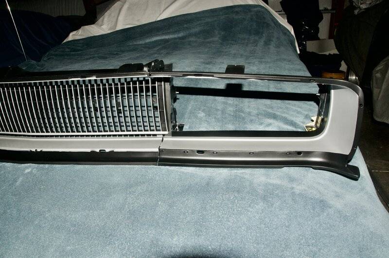

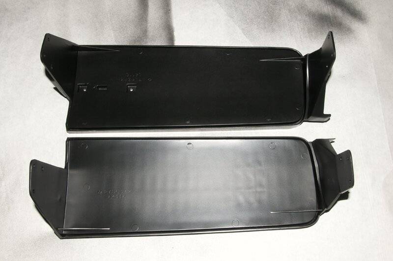

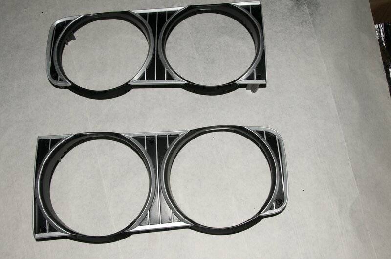

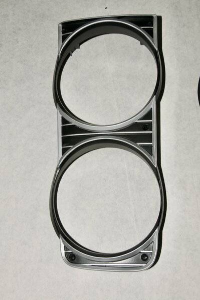

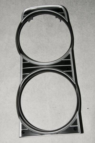

Great work!!Unfortunately to some degree, these and the rest of the grill are for a customer. They have to be damn near perfect because they will be unpacking them and seeing them up close and personal. What I have so far after a lot of hours: Zooming in I can see a couple of little things that need touching up. Then, I hope I am done with these!
View attachment 1119212 View attachment 1119213 View attachment 1119214

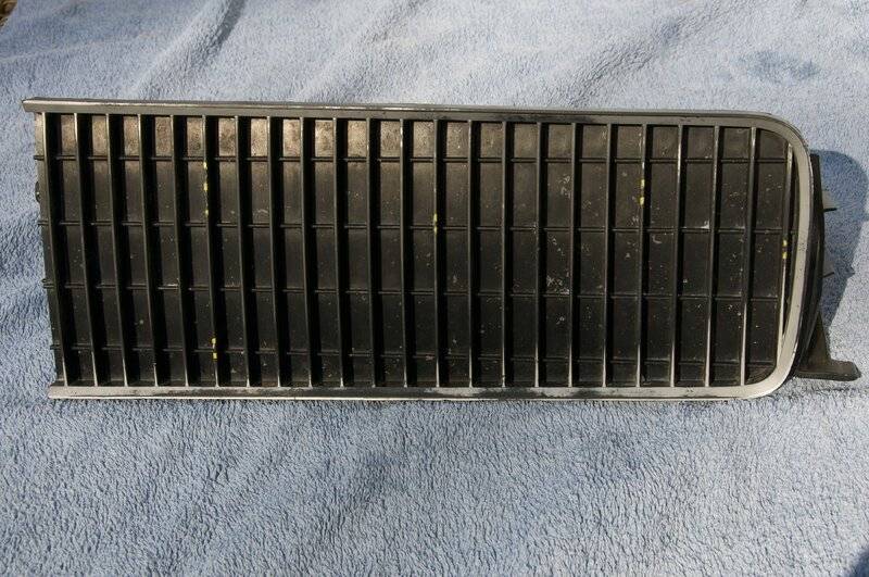

Here is an Nos 69 Charger Grille center just to see the color used in this batch of grilles... View attachment 1119359

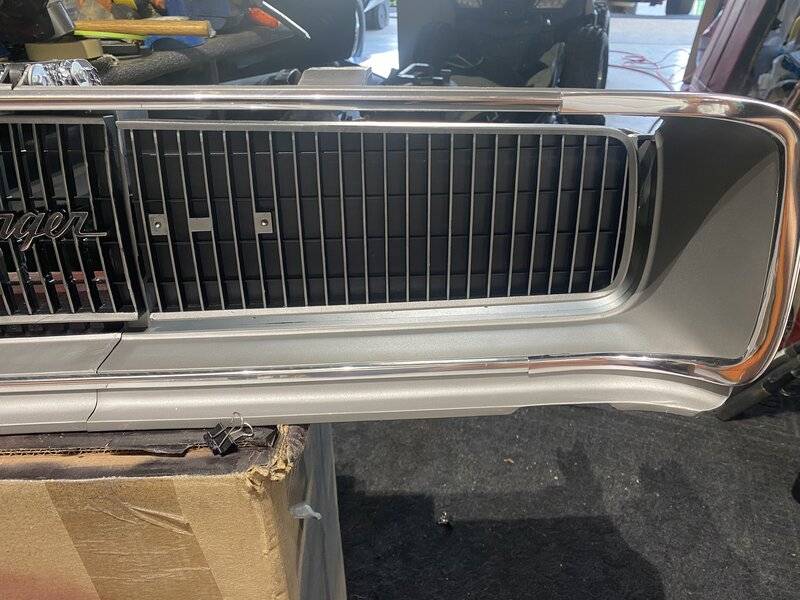

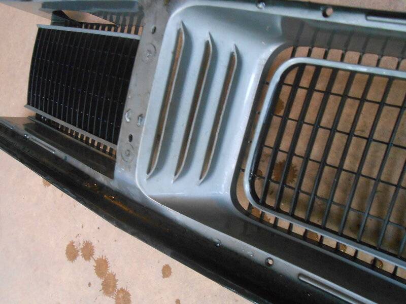

Your Welcome, here’s a pic of my drivers side grill hide away , I’m happy with the results , the trim was tricky , I’m going to touch up the grill with black, to cover up the inside edges of the slats , where the silver over runs in places , I agree a labor of time & love , I’ll send a picture of the rest of it ,soon , I would like to see yours , when your done , Thank youCould be better but at some point I have to stop. There are things I would do different if I had to do this again....
I can get some better ones over the weekend...Got any more photos? I'd love to see them! It's interesting to see one of these that hasn't been through years of driving abuse.

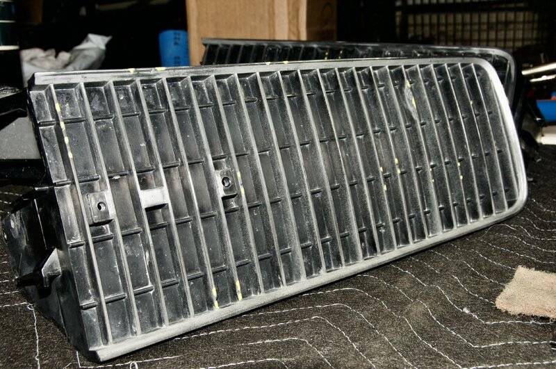

Hi I used SEM Trim Black 39143 & SEM Titanium Silver & SEM Adhesion Promoter for prep I used a soda media blaster I got off Amazon, built a card board box on top of 4’ table with a plexiglass 3’x2’ see through window for blasting soda works best
as it’s water soluble just rinse off the parts , dried them completely, any flaws or chips in the plastic I used jb weld for plastics waited 24 hrs and sanded with 400 & 800 grit wet sand paper each piece was then heated up with a heat gun ,then applied the Sem adhesion promoter follow directions on the spray can , heating between Sprays , then blacked out parts that require black, taped off the silver areas using different widths of masking tape , let dry 24 hrs , then taped off black areas , then more adhesion promoter & heat gun then sprayed Sem Silver titanium go lightly with sprays then get heavy then heat again between sprays , it stops running if you spray to much, let dry 24hrs, to get the silver stripes back to original I used a square piece of foam , pinched it off with a paper spring clip so just about an 1/8” of it was protruding at the end
You can see the pictures in this chat ,borrowed from the Mrs 2 pie plates with tinfoil protection, I sprayed adhesion promoter in one plate , the other silver paint
and gently brushed on promoter down each grill slat , then heat , then silver down each slat and more heat , go lightly don’t worry if you don’t get the paint on immediately, I gave mine 3 coats take your time have a beer and think how beautiful it will turn out , Good luck , I hope I helped you out Cheers !!!
