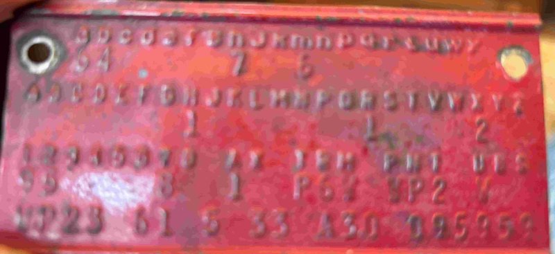

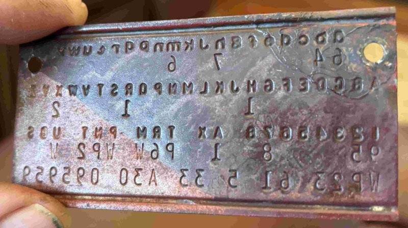

Finally figuring out how to shrink photo file sizes so they will upload - here are pics of the tag.
Thanks for the info on the codes. Is there any way to figure out manufacturing plant if it is not on the Fender tag?

Given that:
the tag does not show typical St. Louis plant stampings
the tag does not show typical Lynch Road Markings
the poster is in California
the tag shows typical LA plant small font.....
I'm going to guess it's from the LA plant and the VIN is WP23G8E116XXX or 117xxx

Thanks this makes sense to me too!
If you look at the top of this Forum "1968-1970 mopars" there's a Sticky "Something to help decode your vin and fender tag 1968 only"
