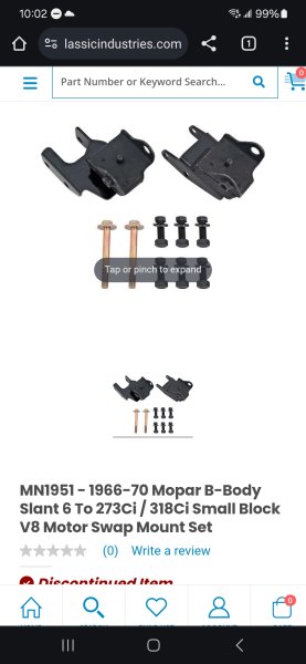

Not sure if any one has them anymore...or who made them..guessing schumaker? These are sb..I would guess bb was made..and not sure if either is available.
