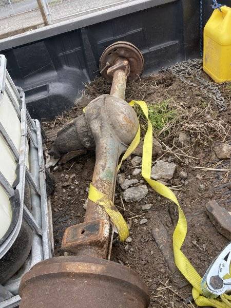

No progress on the car but did buy another rear end. It was about an hour from my home but I had to go to the area anyway. Guy didn't know anything about it other than his shop pulled it from a 69 Roadrunner (according to him). He wouldn't scrape the gunk away to tell me anything about it. I got it home and cleaned enough to see what it is. Not unhappy with it as I mainly wanted the third member. Need to find a place in the area to rebuild/re-gear the third member. Eventual goal is to get them both rebuilt, so I'll have one low geared, one higher.
I guess you was wanting a 489 third member? Your probably gong to keep the sure grip?
742 is a good setup. Just as strong as a 489, and doesn't use a crush sleeve. I run one in my Duster.
I was actually just hoping for another 742. Both of mine seem to be open differentials.
I am still learning and relearning the Mopar world. I was trying to stay away from the 741's and the really early third members. But my reasons were based on stuff I read here and elsewhere on the net, so I really am at the mercy of what info I stumbled across. Either way, this won't be a high horsepower car, and will be running street tires (at least for a long while).

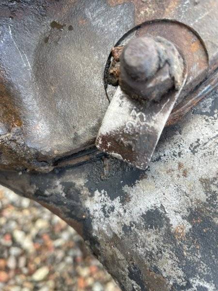

Started cleaning up parts and while messing with the K member I recalled that on a separate thread we weren't able to get a date off of the K member when I was trying to figure out about when my car was built. I checked the area in the front of the K member where the date code should be stamped and found this...
The consensus was that that number wasn't a date code and that there was probably another number near it. I haven't checked the underside thoroughly yet, but there isn't another number on that forward facing portion. I did find these...

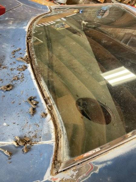

I pulled the back window and found rust, as expected. I need to clean up a bunch more to see how bad it is but I am happy it is out. It had plenty of adhesive and what looked like grey plumber's putty jammed in under the trim.
I know the 4 door parts car has a different shaped back window but I am thinking it might still be able to provide some patch pieces for the rotted areas, rather than having to form the angle.

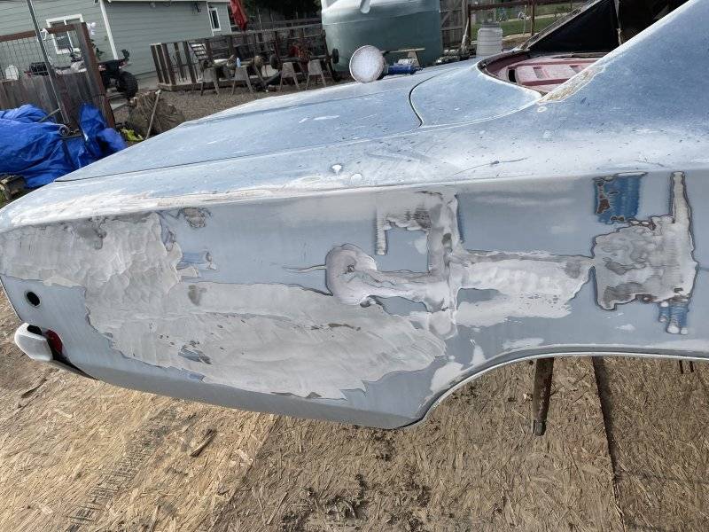

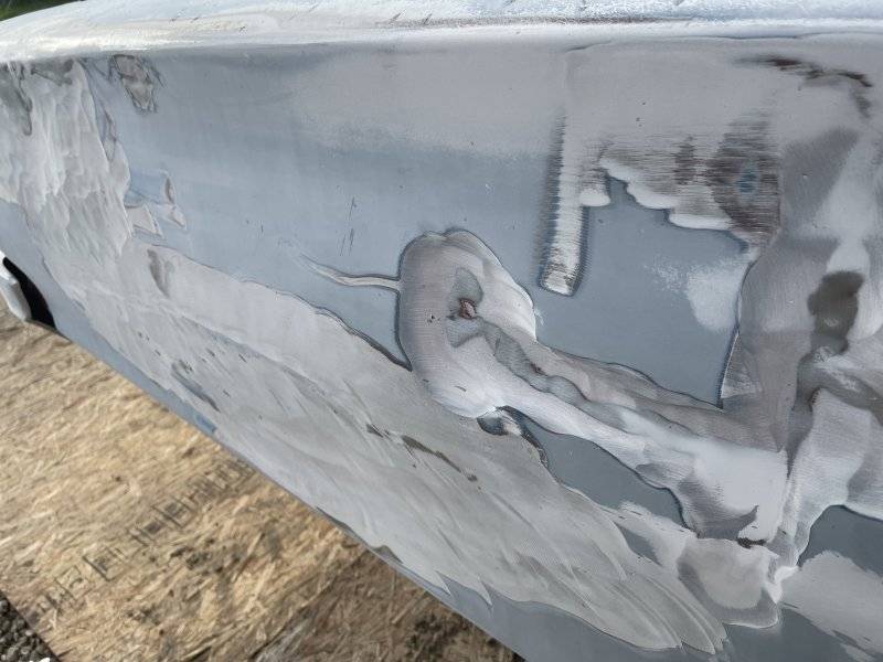

Pushed the car outside so I could clean up a bit in the shop. It was windy as hell so I thought it would be a good time to do a little bondo probing on the passenger quarter panel. I knew it was bad because I could see ugliness inside the trunk.
You have to give the bondo sculpter some credit for his skills. It looked like this when I got the car...

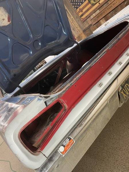

I intend to paint the car the original red. Found a bunch of the original paint behind the tail trim. I guess masking all around it was easier than removing some nuts.
Funny thing is, when they painted it blue, over the red, they saved the jacking instructions sticker on the trunk lid.
It was windy down here too. Looks like you got the classic "cave and pave" fill job. It never stops to amaze me at how people would would spend big bucks on something else, but body repair and paint always got the "it costs too much" syndrome.
It always amazes me at how good some guys can smear and sculpt bondo.....
