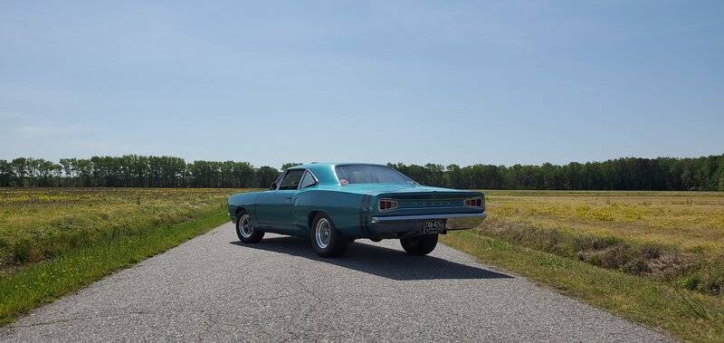

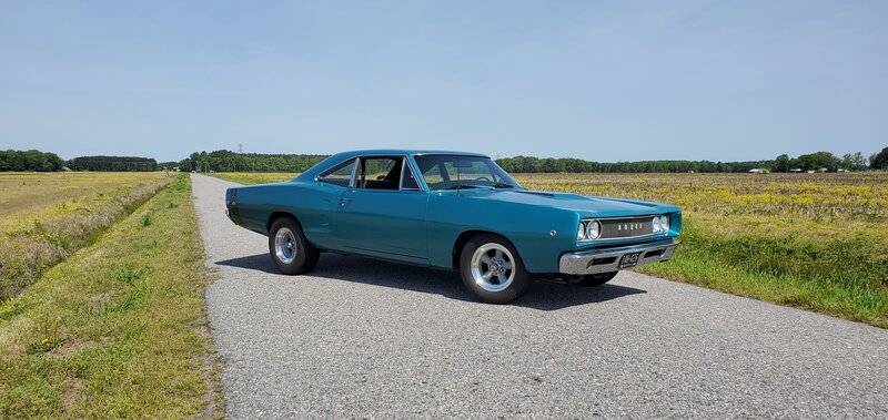

Got nothing for ya on either of those...but here's my 68!
I bought the car from the first Owner in 1978. 2 bbl and 2.91 rear end because he towed his boat with it. He was an executive at Nave Dodge, Novato CA then. Rebuilt the stock 383 and slapped a 4 bbl intake and carb. Beat the **** out of it until 1985. Hasn't moved since. Retired Sheet Metal Worker - Local 104, SF. Ready to resto-mod the car. Would love advice on modular front and rear suspension. Can I get 550+ HP out of the original 383? The site wouldn't allow me to upload more than one image - Jay
