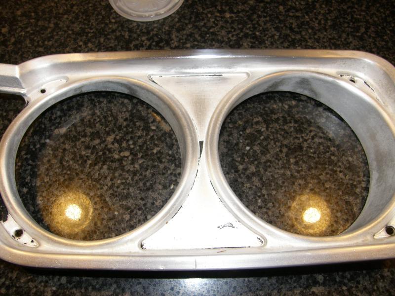

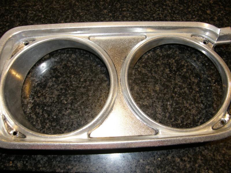

OK, here is what they looked like before I started.

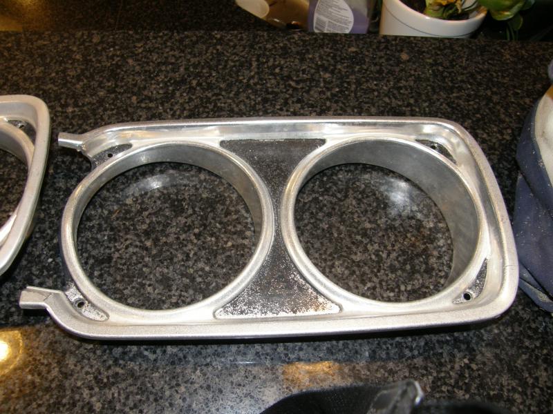

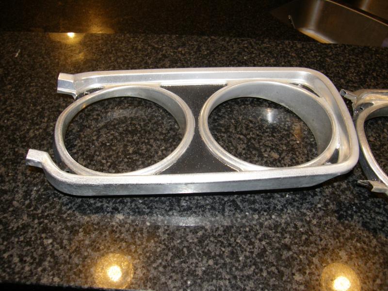

The first picture is after cleaning and removing the paint.
The second is after I removed the coating.

There not that bad Dave. I guess I am sick of polishing. I have been polishing my trim around front and back glass forever. So are you going to powder coat them and if you do please post them for me. Thanks.
