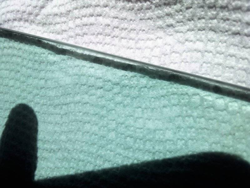

I had a minute yesterday, so cleaned I a window and took a pic. '68 factory A/C Charger w/ all original glass - Bounty plain paper towel as the white.
